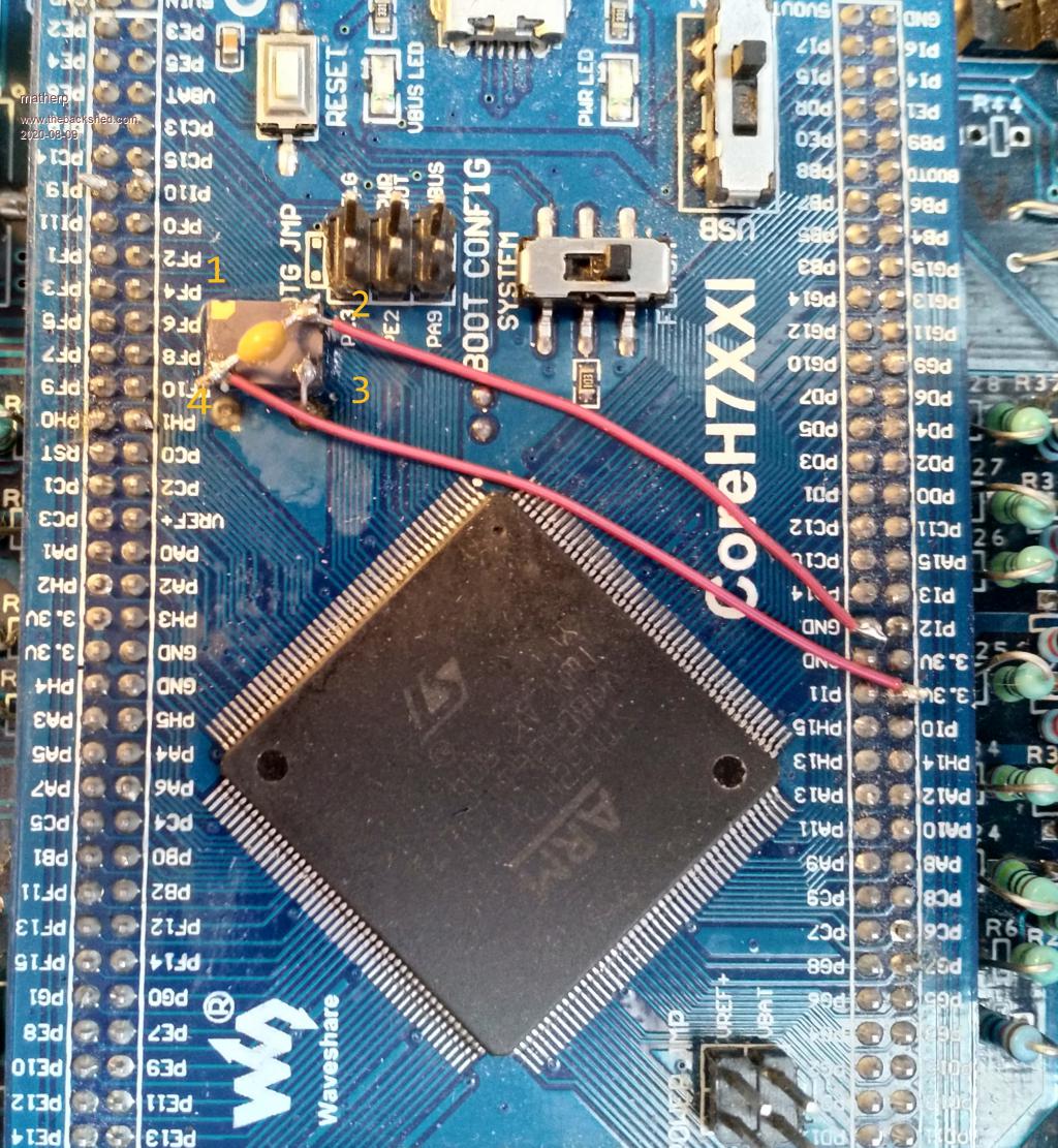

I have done both my boards using the dead bug style like in Peters photo.
You don't have to remove the old crystal so it can all be done without removing the Waveshare module.

I will have to give the dead bug fix a shot! The dead bug fix crossed my mind but I was not sure if it was necessary to remove the crystal. This is great news.

I am glad to say that dead-bugging the oscillator as matherp depicted fixed the issue entirely for me. My CMM2 now works at full 800x600 resolution on any display device I try it on. The fix was easy to do. Thank you everyone for your support!
