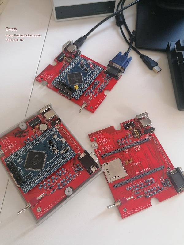

At this point I have assembled three CMM2 boards. All of them works perfectly, except for the SD card reader. I have tried several different SD cards, or course.
At this point I am trying to convince myself that I am wasting my time. I really should pull from the CMM2-project, since I cannot get it to work. At an earlier time I "designed" a CMM1 pcb, with another kind of SD card module - that works perfectly.

In the PCB pictured without the Waveshare you are missing the 2R2 resistor that powers the SDcard. Won't work without that!

  matherp said  In the PCB pictured without the Waveshare you are missing the 2R2 resistor that powers the SDcard. Won't work without that!
Also, if after fitting that resistor it still plays up, check your voltages.  Measure between the USB-B case (-ve) and the 5VIN and 3.3V pins (+ve) on the Waveshare.  Should read around 5v or a tad over, and 3.3v.
Then try with a different USB-A to USB-B cable.
Also some early firmware versions dont like a blank formatted SD card, now fixed in the latest firmware.

matherp, I have tried several "combinations" back and forth - Upon using solder wick on the SD card solder pads and including/resoldering the 2.2 ohm resistor I got two of the boards working!

I discovered that dabbing some liquid flux onto the solder braid using a "flux pen" vastly improved the efficiency of the braid to wick up excess solder ... might help you with the third board
