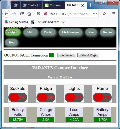

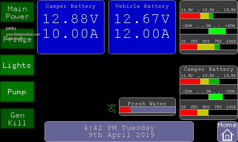

It is certainly possible. I have loaded Annex Basic into an ESP8266 and run a program on a Maximite Plus.
The Maximite+ monitors a number of switches and controls relays in a camper trailer. It connects to the ESP8266 via serial and the Annex basic program in the ESP8266 'remotes' the switches. These can then be operated by my smartphone using wifi.
sw_9.zip
The image above is a sample of the MM+ display (which is hidden in an outside accessible panel      ) - I use the 8266 to remote the controls inside the camper trailer so I can controls things from bed using my phone!.
sw_9.zip includes the Annex Basic code for the 8266. Annex Basic is pretty easy to use as it is very similar to MMBasic. To link the two, you just need to determine a data exchange protocol (mine is very simplistic) and run it over a serial link.

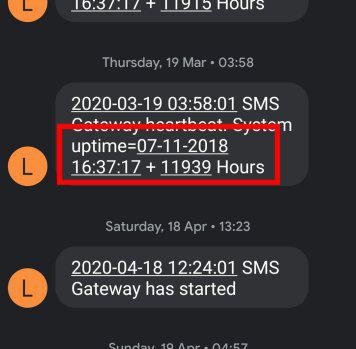

the 8266 is getting a bit "old" now and there are probably better modules but they will still provide what you want and they are cheap as dirt, and more importantly, they just "work"
here  is the guts of my 8266 based server. It is not a trememndous amount of code; under 8k with comments and general support functions useful elsewhere. The code is a bit shonky by my standards today - I was still fairly new to MicroMites in 2016 - but it does what it says on the tin.
It is multi-channel and handles the simultaneous connection for 5 (or is it 6?) inbound HTTP channels. You have to parse the actual page responses yourself (this is the meat of your API) but it will do all the tedious mucking about of the headers etc and you can clearly see where to insert your own stuff.
There are also a *lot* of links that I used when i was getting this working. Can't claim to them still being up, but they helped me when I was writing the code they might help you too.
This was a section of my GSM gateway (web to text message + handling of inbound text messages) - that is on FotS also if you need to see it used in anger.

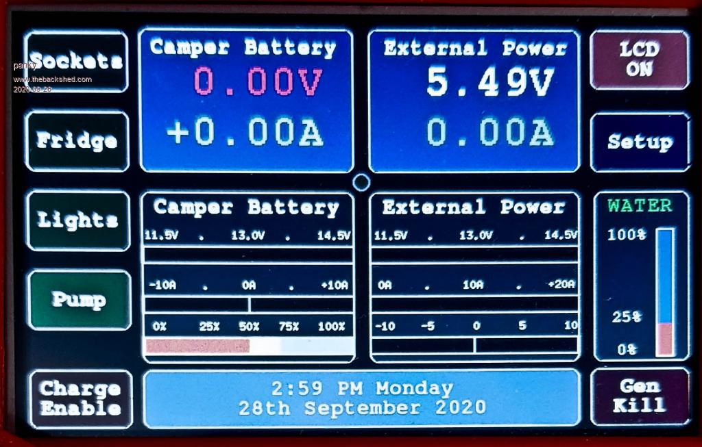

MMBasic lcd display (updated from previous but SAVE IMAGE decided not
to work for me so quality is ordinary).
The MMBasic program is running on a custom MM+ board that has relays and current sensors. Display is a 5" LCD. The Annex Basic is running on a WiMOS D1. The 2 are linked via COM1.

honestly not had a problem. this system has an uptime of 1.3 years(!) until I had to tweak the code and it started again. MM2 5.0408, ESP8266+M590 GSM module

1. To learn about Annex Basic, go to here for all the info on loading Annex Basic and how it all works. There is also a serial flasher as part of the BASIC toolkit to flash the ESP chips.
2. The serial link between the 8266 and the MM is direct hardwire (they are in the same box).
3. Yes.
4. Yes.
5. Yes. There are a couple of different ways to connect to the 8266 - you can set it up to be part of your own sub net and access it via your router or you can connect directly to it's own sub net (it appears as a WiFi network ESP86: followed by its MAC address. It defaults to an IP address of 192.168.4.1)
6. The HTML scripts in the 8266 act as a web server - they are accessed by any browser, doesn't matter what platform. There is no additional code or apps needed on the device you access the 8266 via WiFi. That is, it can be phone ,tablet, PC, MAC etc. The 8266 has embedded Javascript code to link the HTML that your browser is acting on with Annex BASIC in the 8266. This in turn interacts with the serially connected MM.

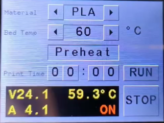

  MikeO said  Sometimes the code involved to make a user interface can be a larger effort than the actual code for the project.
So true. I built a heated bed controller for my 3D printer - it spent months running as a "terminal application" because I just couldn't face the aggro of a custom screen. It took me a month of pondering to come up with this
.. but I am fairly happy with it. It's moved into a daily user state so... a few wrinkles but mainly with the underlying operation. Provides all the functionality I need in an almost "finger operable" touch display.
I always aim for that Windows95/CE look. I have developed a few routines that make it easy(er) but I plan to do a grid based system when I get time, which should make it all really easy (the code to parse the touches and equate to a button is a pain).
