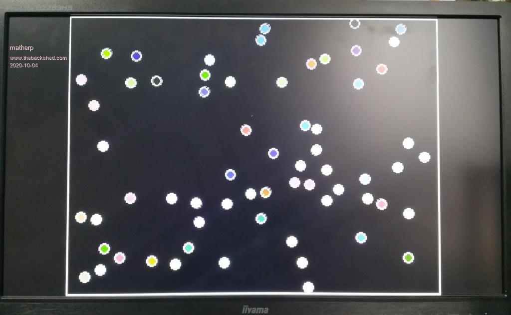

You will need to download V5.05.06b16 for this demo as it uses a couple of new SPRITE functions:
http://geoffg.net/Downloads/Maximite/CMM2_Beta.zip
SPRITE(T,spriteno) ' returns a bitmap showing all the sprites currently in collision with the requested sprite. Bits 0-63 in the returned integer represent a current collision with sprites 1 to 64 respectively
SPRITE(E,spriteno) ' returns a bitmap showing which if any edges of the screen the sprite is in contact with:
 If sprite(E,spriteno) AND 1 Then
   'collision with left of screen
 Else If sprite(E,spriteno) AND 2 Then
   'collision with top of screen
 Else If sprite(E,spriteno) AND 4 Then
   'collision with right of screen
 Else If sprite(E,spriteno) AND 8 Then
   'collision with bottom of screen
In addition b16 fixes an issue with SPRITE HIDE ALL status not being cleared correctly
This demo hammers the SPRITE engine with 64 sprites moving all over the screen and never being allowed to overlap. Video here
option explicit
option default none
option console serial
mode 7
page write 1
'brownian motion demo using sprites
dim integer x(64),y(64),c(64)
dim float direction(64)
dim integer i,j,k, collision=0
dim string q$
for i=1 to 64
 direction(i)=rnd*360 'establish the starting direction for each atom
 c(i)=rgb(rnd*255,rnd*255,rnd*255) 'give each atom a colour
 circle 10,10,4,1,,rgb(white),c(i) 'draw the atom
 sprite read i,6,6,9,9 'read it in as a sprite
next i
cls
box 0,0,mm.hres,mm.vres
k=1
for i=mm.hres\9 to mm.hres\9*8 step mm.hres\9
 for j=mm.vres\9 to mm.vres\9*8 step mm.vres\9
   sprite show k,i,j,1
   x(k)=i
   y(k)=j
   vector k, direction(k), 0, x(k), y(k) 'load up the vector move
   k=k+1
 next j
next i
do
 for i=1 to 64
   vector i, direction(i), 1, x(i), y(i)
   sprite show safe i,x(i),y(i),1
   if sprite(S,i)<>-1 then
     break_collision i
   endif
 next i
 page copy 1 to 0
loop
Sub vector(obj As integer, angle As float, distance As float, x_new As integer, y_new As integer)
 Static float y_move(64), x_move(64)
 Static float x_last(69), y_last(64)
 Static float last_angle(64)
 If distance=0 Then
   x_last(obj)=x_new
   y_last(obj)=y_new
 If angle<>last_angle(obj) Then
   y_move(obj)=-Cos(Rad(angle))
   x_move(obj)=Sin(Rad(angle))
   last_angle(obj)=angle
 x_last(obj) = x_last(obj) + distance * x_move(obj)
 y_last(obj) = y_last(obj) + distance * y_move(obj)
 x_new=Cint(x_last(obj))
 y_new=Cint(y_last(obj))
Return
' keep doing stuff until we break the collisions
sub break_collision(atom as integer)
 Local integer j=1
 local float current_angle=direction(atom)
 'start by a simple bounce to break the collision
 If sprite(e,atom)=1 Then
   current_angle=360-current_angle
 Else If sprite(e,atom)=2 Then
     current_angle=((540-current_angle) Mod 360)
 Else If sprite(e,atom)=4 Then
 Else If sprite(e,atom)=8 Then
 Else
   'collision with another sprite or with a corner
   current_angle = current_angle+180
 endif
 direction(atom)=current_angle
 vector atom,direction(atom),j,x(atom),y(atom) 'break the collision
 sprite show atom,x(atom),y(atom),1
 'if the simple bounce didn't work try a random bounce
 do while (sprite(t,atom) or sprite(e,atom)) and j<10
   do
     direction(atom)= rnd*360
     j=j+1
   loop until x(atom)>=0 and x(atom)<=MM.HRES-sprite(w,atom) and y(atom)>=0 and y(atom)<=MM.VRES-sprite(h,atom)
 loop
 ' if that didn't work then place the atom randomly
   x(atom)=rnd*mm.hres-sprite(w,atom)
   y(atom)=rnd*mm.vres-sprite(h,atom)
   vector atom,direction(atom),0,x(atom),y(atom) 'break the collision
 loop

After nearly 3 hours running, it finally gave up with
  Quote  Error in Line 99: -9 is invalid (valid -8 to 239)
Posts: 12046
Posted: 07:51am 04 Oct 2020
  Quote  After nearly 3 hours running, it finally gave up with
Oops missed a bracket
  x(atom)=rnd*(mm.hres-sprite(w,atom))
  y(atom)=rnd*(mm.vres-sprite(h,atom))
Also change line 33
  sprite show i,x(i),y(i),1
  Quote  May I have permission to include it on the Welcome Tape please?
  Quote  May I also add it to the Graphics Programming Manual please?
Any Basic code I post can be used for any purpose - appreciate the courtesy but no need to ask
I'll have a play later today and see if I can get the physics better
Edited 2020-10-04 19:22 by matherp
