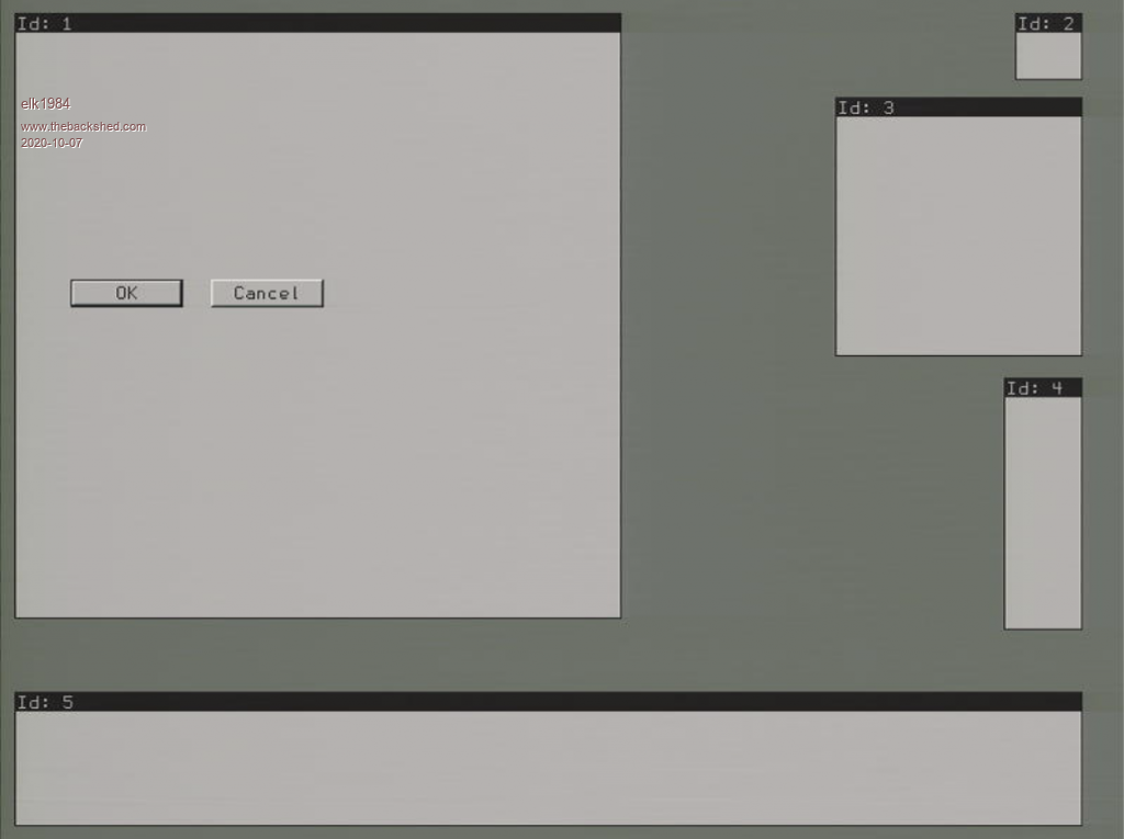

This is very rough and ready, but I'm putting it out there for comments & suggestions on how I might do this better (or indeed if it's a total waste of time!)  I don't want to go to Csubs (mostly because I can't code in C!)
wimp.zip
Features
- Movable panels (implemented as sprites and I'm sure this is a problem because it's easy to get up to the sprite limit with 64 controls on a page!)
- Buttons (default and normal)
- Show/Hide control
- Move control
To Do:
* Relative positioning (so the X and Y coordinates are defined relative to the container control rather than the screen)
* Z-Order (the hiding of ID: 2 leaving the background to ID: 1 visible when Id:5 would need to redraw; the hiding of Id: 5 leaving part of Id: 2 visible when Id:1 would need to redraw)
* Implement the other controls!
* Navigation (Keyboard / Nunchuk / Wii Classic / Mouse?)
* Memory usage - I'm sure I'm swallowing loads in all those string arrays!  I think maybe implementing the Container / Controls as a tree?
* Recursive redraw (repainting a Container causing all contents to draw)
Comments welcome.

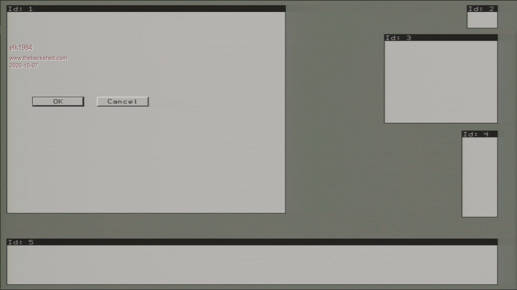

Screen capture using new VGA Capture Device

Video capture uploaded to here showing frames moving and the Z-order problems.

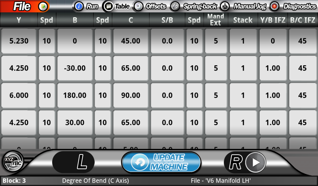

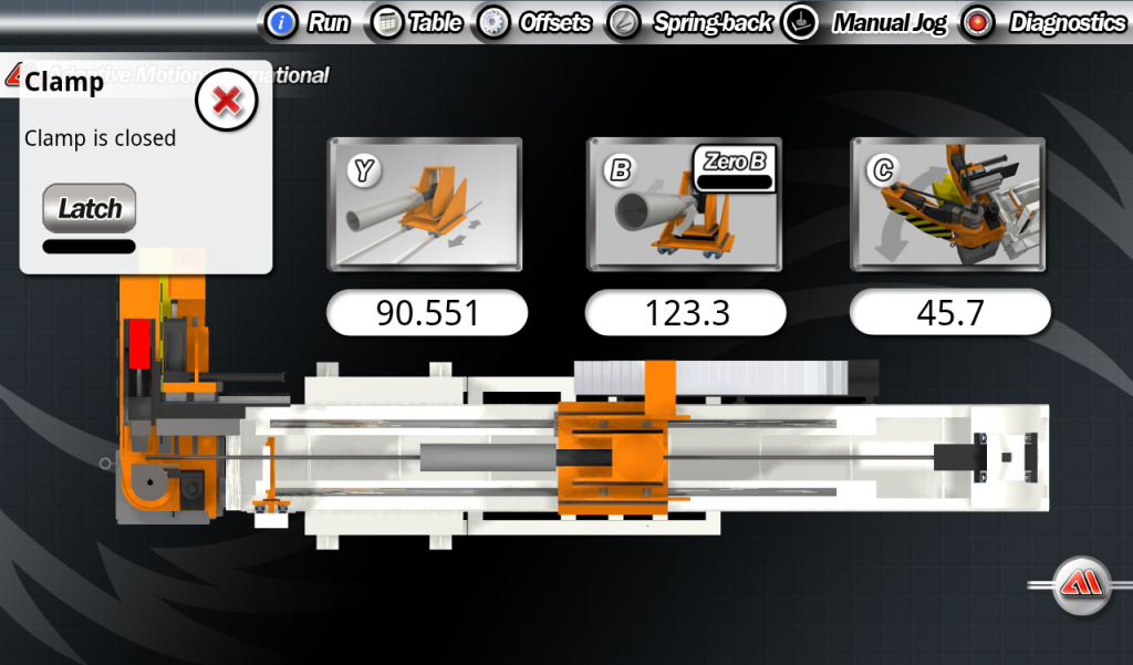

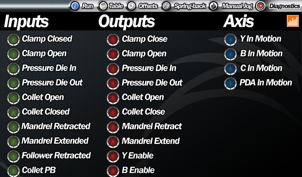

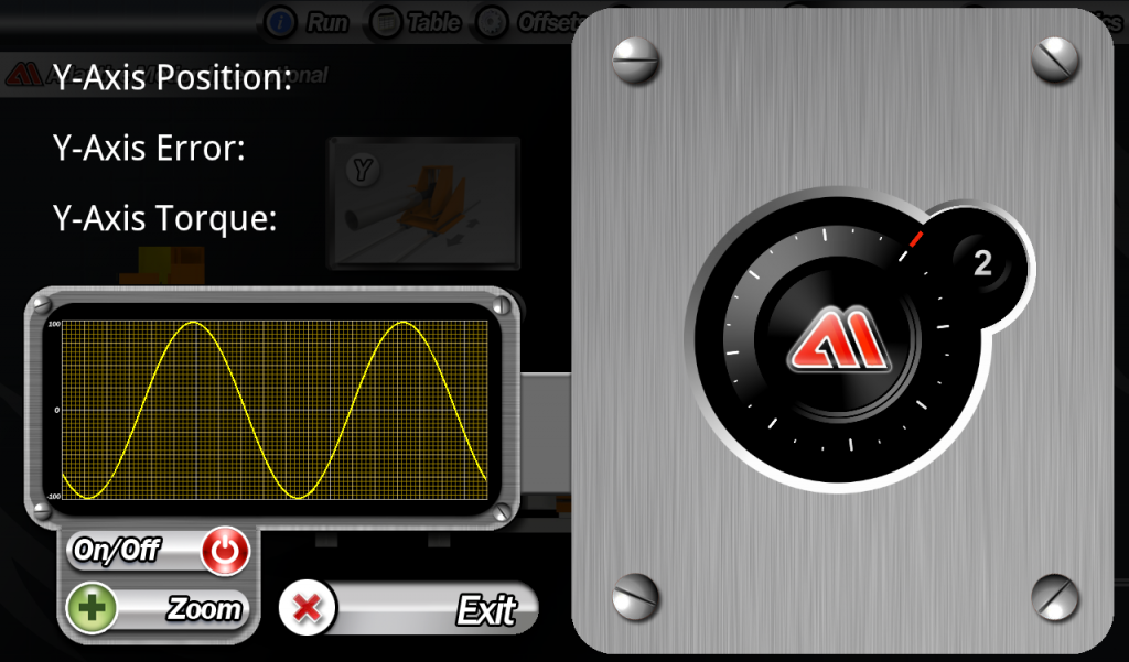

Here's what I have been doing since my DOS days because I never saw the point of drawing GUIs in code.

Make use of the graphics capabilities of the CMM2, especially the page flipping.
Do a search for:
Knobman
Skinman
Creator: g200kg
I'd post a link but a search will reveal more.
The photo-realistic graphics for audio devices, etc., are created with these tools.
The rotary dial used in my top image was created with Knobman

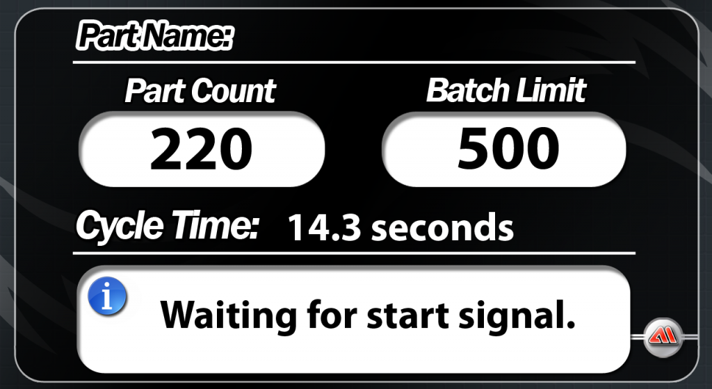

Some elements to play with:
Graphic elements 1.zip
Graphic elements 2.zip
Graphic elements 3.zip
Graphic elements 4.zip
Note that the file names have the image size in parentheses. Re-name them as just png. Use a graphics program to size the image to suit. These are transparent backgrounds....I believe most graphics programs support this, now.

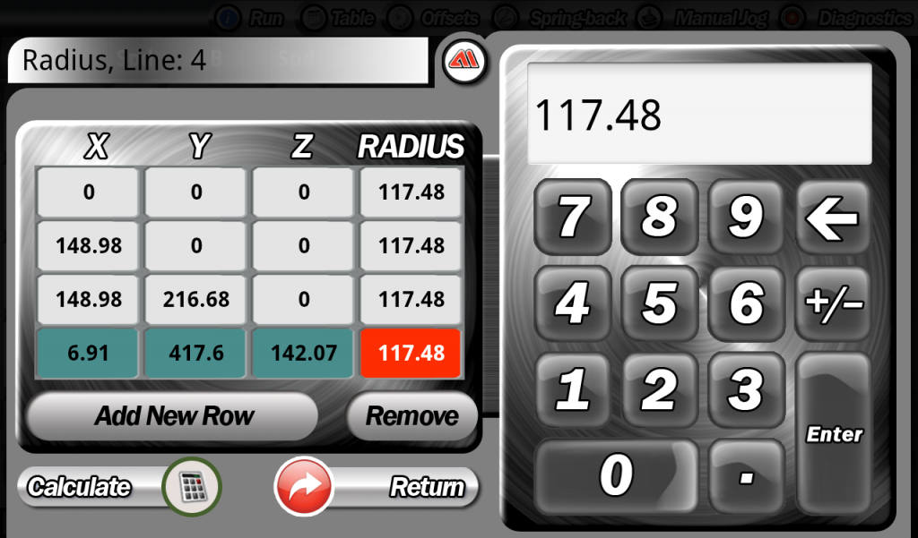

Fancy text
Create buttons
