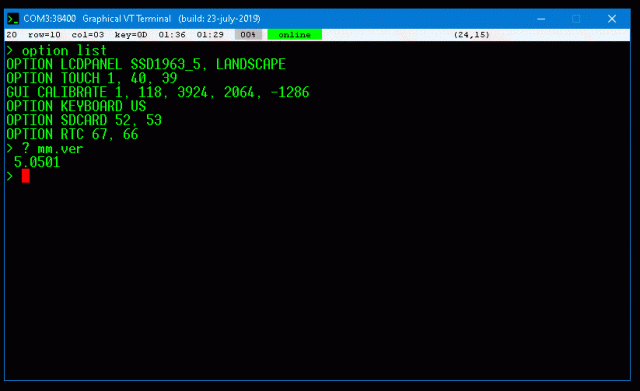

Posted: 06:03am 06 Nov 2020
Just an little update on this, as I was setting up an E100 unit for a client, and I loaded the 5.05.01 firmware, and can setup all the options just fine - I got no complaint about pin-1 being reserved.
@ dishlikker: have you tried another regulated power-pack yet?
With a 5" LCD connected and initialized, the current consumption from 5v is about 400mA, so you really need a 5v @ 1A fully regulated plug-pack.  Something like this from Jaycar: LINK
