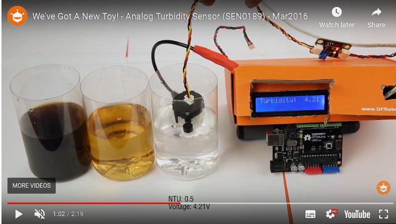

SEN0189
https://iopscience.iop.org/article/10.1088/1742-6596/1280/2/022064/pdf

Posted: 10:07pm 08 Feb 2021
I don't have a downer on this device, but I am even more convinced this will not provide what is needed in the tank.
Looking at Wikipedia regarding NTU, the very first picture tells pretty much all you need to know. NTU of 5 is almost still clear water and 50 is unmistakably obvious to the naked eye. Taking these two values to fig 6 and both would barely register voltage-wise and be quite difficult to separate from fluctuations in ADC readings:
0NTU  =3.9994V
5NTU  =3.9954V
50NTU =3.9594V
Just 36mV between barely noticeable versus quite milky and I figure you'd be well below 50NTU in practice
Something else that occurred, things suspended in aquarium water tend to get a bio-film coating of slime - bacteria and algae so the efficacy will drop over time leading to false positives. Even with cleaning I reckon your base-level will drift and the thing will need calibrating reasonably often.
Of course all this depends on how serious-an-application... for a bit of fun it will demonstrate the principals.
Oh, and there is the 3.3V input to the ADC thing, so you'd need a potential divider on the output of this sensor.

Posted: 10:12am 09 Feb 2021
@CaptainBoing  >> great summary and you raise some interesting issues.
You're right - I hadn't got round to considering the range of the NTU -- even when the tank is "dirty" it will be around 5NTU -- so the sensor are unlikely to be sensitive enough.   And the biofilm will kill off that sensitivity eventually.
That said, for 20UKP I think I'll still have a look and see if I can replicate the IOP paper from @lew247

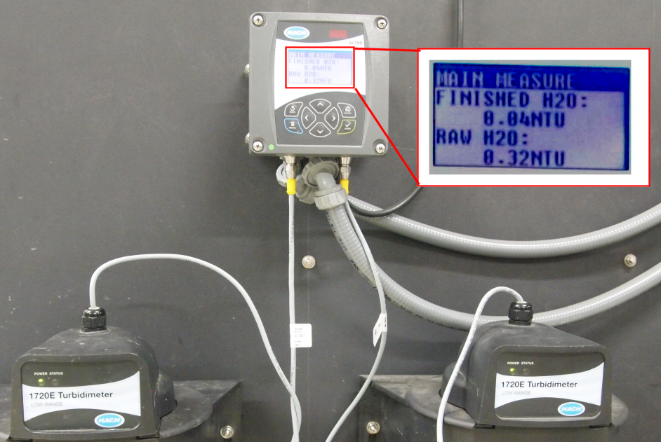

Posted: 12:03pm 09 Feb 2021
last word, that pic on WikiP for a potable water filter shows the following in/out NTU. (big boys toys Turbidimeter 1720E - yours  for a cool 300 sovs)
