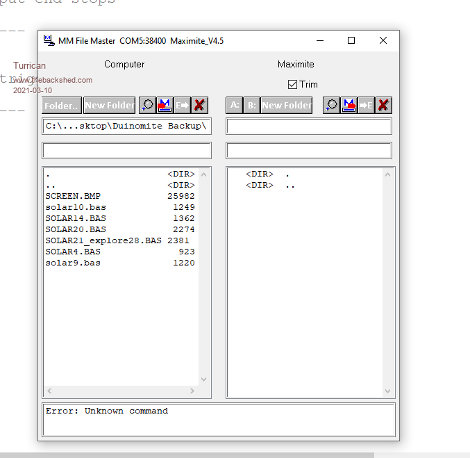

I use the Load and Run function in MMEdit to send my program to the Micromite but I am still a but puzzled on how to retrive the current program from the Micromite back to the MMeditor.

Yes, that is how I have tranfered files on my Duinomite but the Micromite Explore 28, afaik dont have a file system and can not save or load files. therefore there no file to transfer. I am new to the Micromites so I may be wrong. :)

Can you explain how you upload the current memory from the Micromite when there is no file to upload, only the internal memory?

You need to set the correct protocol for the Micromite in the dropdown, far right of the top line. At the moment you seem to be set for the Maximite
