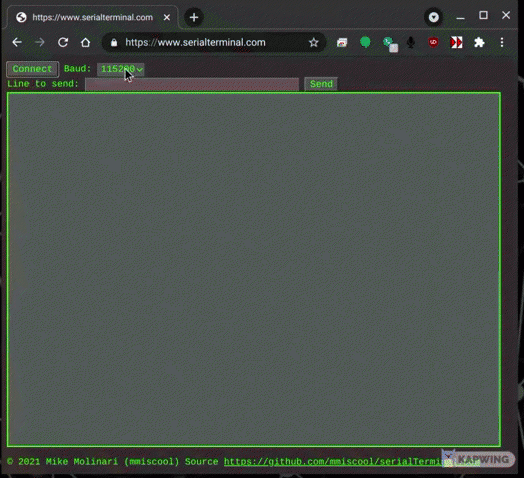

The latest version of the chrome web browser has a javascript API for accessing serial devices. I use a Chromebook as my daily driver so having a working serial terminal is something desirable. I was using an extension but I really hate installing extensions as they can some times be shady. I have been using it for configuring 3d printers but it should work with the esp8266, arduinos, ect.
I threw together this serial terminal example over the past few days and published it at https://www.serialTerminal.com
You only have to select your baud speed and hit connect. It will show you a list of available devices. Just select the one you want to use and you are ready to rock.
You can send text to the device and display what the device outputs on the screen.
A quick video showing how it works.
https://www.youtube.com/watch?v=8577GPmvuUQ
Github link for source code. Less than 150 lines between the HTML, CSS and javascript.
https://github.com/mmiscool/serialTerminal.com

It scrolls down. Can it be made to scroll up?
mmiscool
Joined: 05/11/2015
Posts: 13
Posted: 11:48pm 19 Mar 2021
Just pushed a change. This is now the functionality.

I normally use FireFox which unfortunately doesn't work. Fails at the connect function.
It 'almost' works with Edge browser.
When you have "send with /r/n" selected, a zero gets appended instead of CRLF
files0
Edit:
Reason seems to be that Edge doesn't like +=
if (document.getElementById("addLine").checked == true) dataToSend = dataToSend + "\r\n";
works
Now it needs some way to send control codes such as <ESC> and ^C
Edited 2021-03-21 07:57 by TassyJim

I fixed that bug with the zero getting added. Should be good now.
