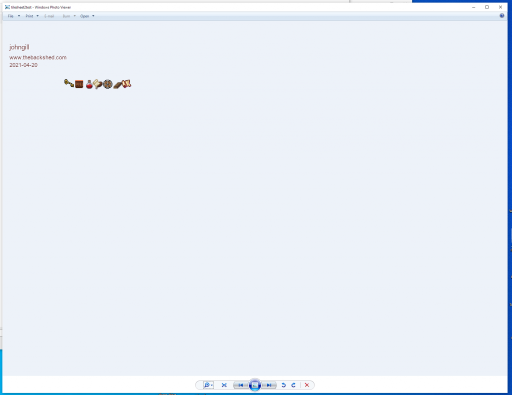

I'm trying to make a 640x400 png tilesheet for my game. I'm using corel Photopaint to export a 24 bit png with a transparent background, and it looks like this on the PC:
I've positioned 7 16x16 graphics in the top left hand corner of the sheet, and that's all it is.

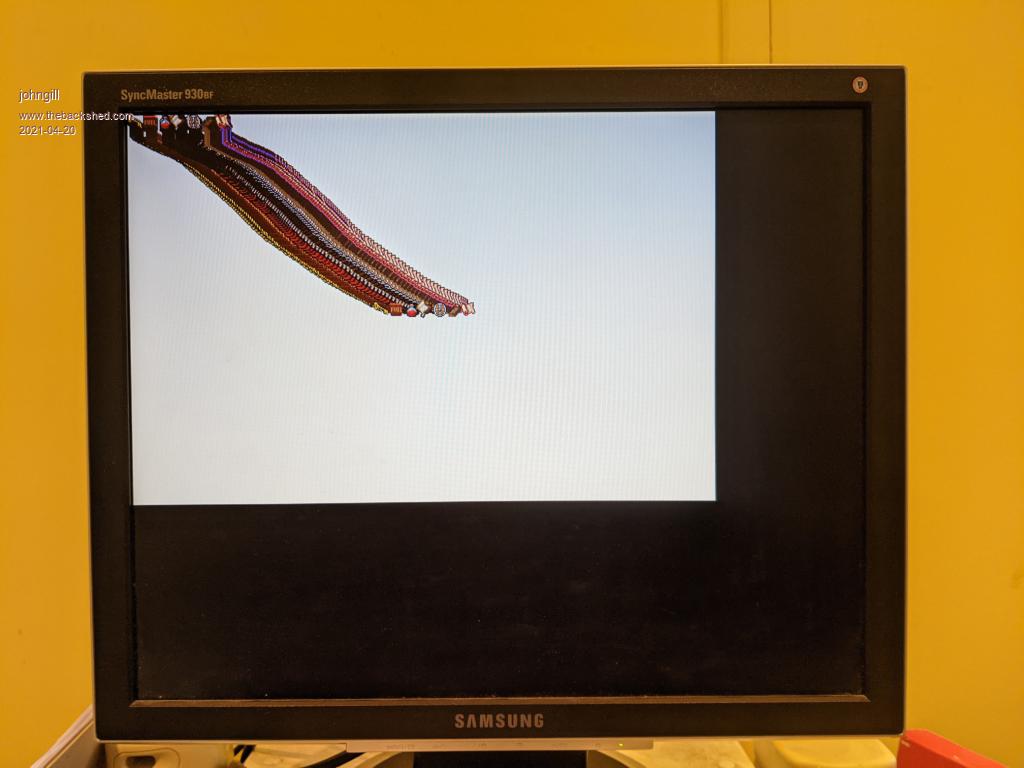

But when I load it up on my CMM2, it goes absolutely bananas:
no kidding - this is exactly the same .png file.
Have I done something dumb? Is photopaint somehow exporting the "transparentness" of the png in a weird way? What can I do to fix it?! Help!

If you post the png file (zip it up) then we can have a look

Posts: 12045
Posted: 06:56pm 19 Apr 2021
Don't know what the problem is but I've just saved as a png using a different program (Very old copy of PaintShopPro) and now it works. I assume corel is using some feature that isn't supported by the CMM2
