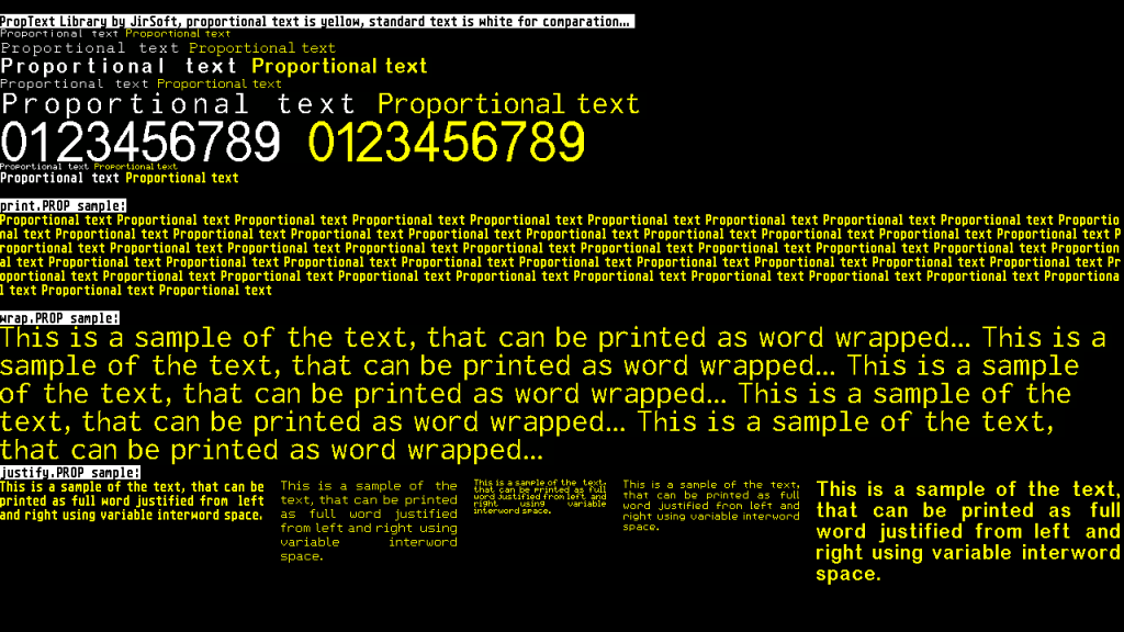

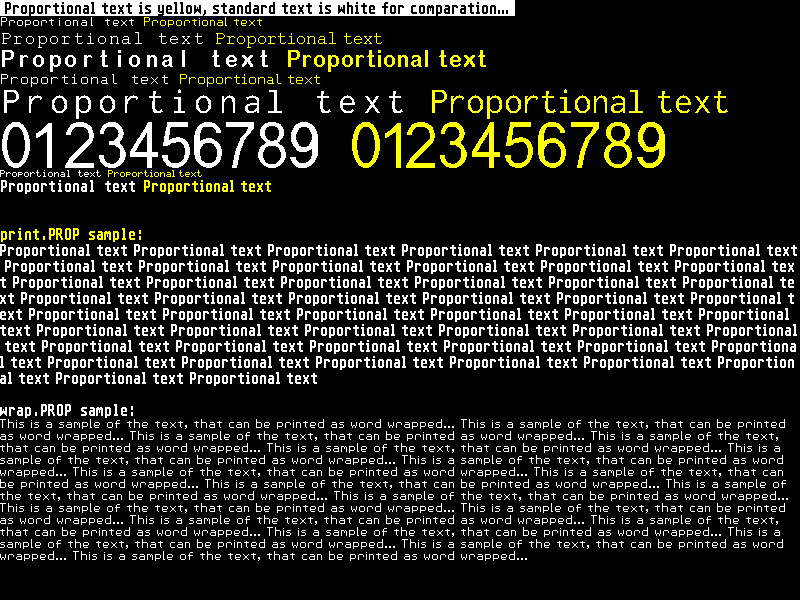

I have put on my GitHub very simple library for outputting of proportional text. It can be used with either built-in or user fonts on CMM2, simply call text.PROP instead of TEXT command...
The best use case can be text adventures (Hi Tom  ), because of better readability of the texts in proportional font.
PropText
Jiri

I have updated this library to version 0.02:
massive speedup because of precalculation of offsets and widths of built-in fonts (thanks Pete  ), so initAll.PROP takes no time.
PRINT like commands:
print.PROP(txt$), printLn.PROP(txt$) and wrap.PROP(txt$)
 all can be mixed with standard PRINT, they use just strings as parameter, last one is word wrapped (can be useful)
color.PROP(front%, back%) is like COLOR, but sets parallel intern variables (because I can't read the environment), so use simply this instead of COLOR
font.PROP(fnt%) the same for FONT
Enjoy!

How weird that the wrap.PROP sample resulted in that vertical gap in the text.
For your next trick, could you force the printed line of (wrapped) text to be a specific number of pixels wide? Then a column of text would be left AND right justified.
Posts: 3837
Posted: 12:16am 16 Jul 2021
  vegipete said  For your next trick, could you force the printed line of (wrapped) text to be a specific number of pixels wide? Then a column of text would be left AND right justified.
Variable-width spaces to right and left justify proportional text--I did that back in 1982--in Fortran.
jirsoft
Joined: 18/09/2020
Location: Czech Republic
Posts: 533
Posted: 07:46am 16 Jul 2021
  vegipete said  How weird that the wrap.PROP sample resulted in that vertical gap in the text.
I think this is just because of repeated text else it will not happen (hopefully  )
I can, but I need to study the typography a little bit... When you can fit more words into set space, it's OK, because you can do it by changing of inter-word spaces. When you fit just one word, can be adjusted inter-char spaces and it looks UGLY   Finally what to do, if you can't fit the longer word into set space at all???

Posted: 02:21pm 17 Jul 2021
Added justify.PROP(txt$, txtWidth%, dx%)...full jutified left and right word wrapped proportional text with size txtWidth% written to offset dx%
Also added one parameter to print.Prop and printLn.Prop:
print.PROP(txt$, addSpace$)...prints proportional txt$ on current position, wraps character to next line, without line feed
If the string addSpace$ is not empty, then to N-th SPACE (" ") in txt$ is added PX pixels, where PX=ASC(MID$(addSpace$, N, 1))print.PROP(txt$, addSpace$)
Usually when the text will be full justified, should be also possibly hyphenated - this wii bring massive amount of work, which I don't think make sense. So if the word not fit into set space, then is simply printed out (and will be wider), in the code is prepared ERROR for this situation when needed.
I'm also not adjust inter-letter space, as I don't like it and inter-word space could be just expanded not compressed (again, when used not so nice and code is much simpler)...
Enjoy!

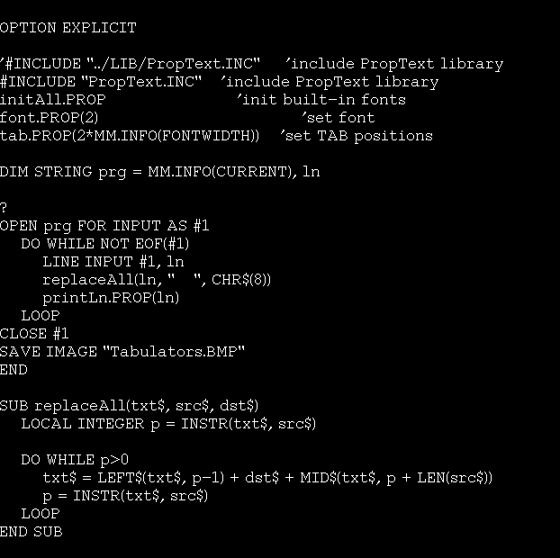

Hi all,
PropText library was updated to v0.04. Main news are support for TAB and LF charecters in print.PROP command, because of it printLn.PROP is simpler now and it was added command tab.PROP(t%), where with t% are set TAB positions to every t% pixels.
I have added Test2.BAS for test...
Enjoy!
