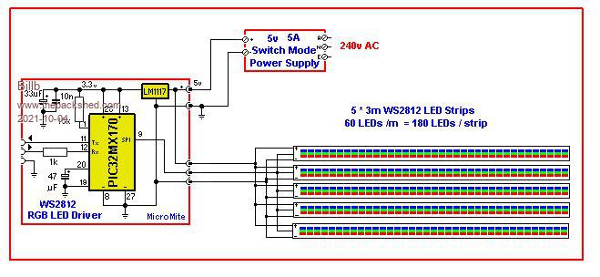

Hi  I have addressed up to 300 WS2812 using a pic32MX170 using peter's csub to handle the comms timing which is critical with these LEDs.
The video below is of 120 LED for a waterfall star for my christmas lights.
I you post the program if required.
120 WS2812
256 ws2812 leds and a pic32mx170 - scrolling display
265 ws2812
sorry about the focus.

This is the carousel program.  I use 4 of 8 X 8 ws2812 modules a total of 256 LEDs

The waterfall star program and schematic.
