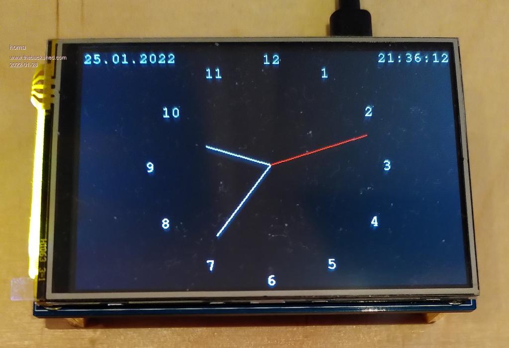

hello, I like analogue clocks.
Here is a simple graphic version of a clock. The second hand jumps, as does the minute hand. The hour hand is sluggish / creeping.
I would have liked to make the hands not only different lengths, but also wide. Unfortunately, the LINE command with diagonal lines only works with the default value of 1 for the thickness.
Does anyone here know the reason for this?
Otherwise, have fun.
Matthias

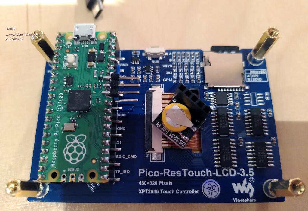

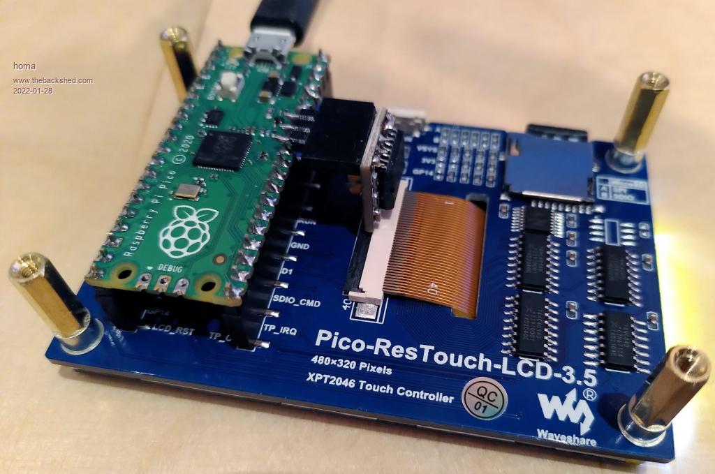

By the way, who cares: I have mounted the DS3231 from amazon plug-in for the Pico ResTouch LCD 3.5 and found it to be a good fit.
> option list
OPTION AUTORUN ON
OPTION COLOURCODE ON
OPTION SDCARD GP22
OPTION SYSTEM I2C GP26,GP27
OPTION LCDPANEL ILI9488W, RLANDSCAPE,GP8,GP15,GP9,GP13
OPTION RTC AUTO ENABLED
OPTION TOUCH GP16,GP17
GUI CALIBRATE 0, 251, 3862, 1278, -854

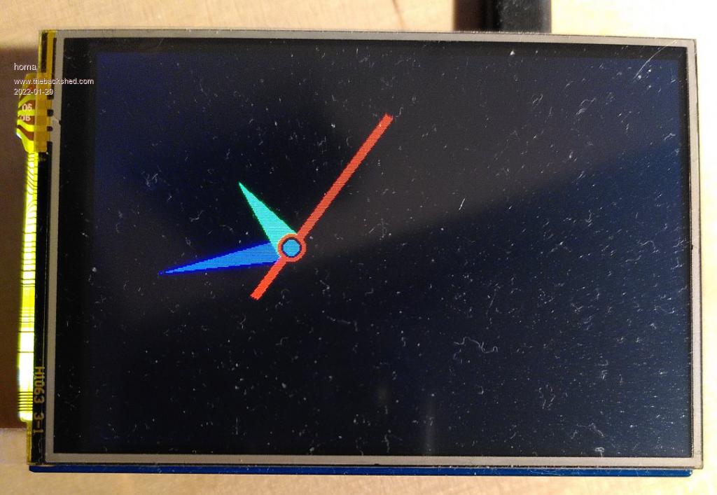

Posted: 09:53pm 28 Jan 2022
Thanks for the code, this is how it looks ...
I don't like the hands with the triangle. But the second hand is great.
I'll see what I can do with it.

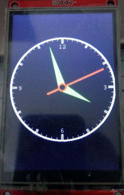

Posted: 05:57am 02 Jul 2022
Here is how it looks.
{Edit: I've just noticed that my LCD is not centered. A -3 reduction in the ana.X and ana.r fixes it. YMMV}

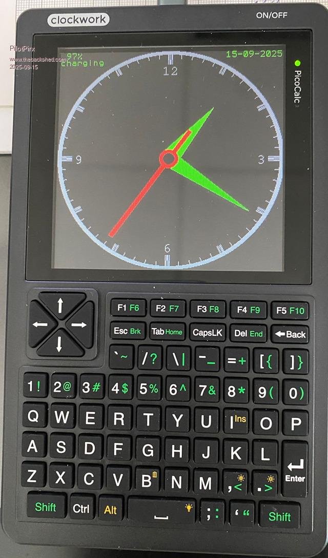

Posted: 11:33am 15 Sep 2025
Works on my PicoCalc too!
