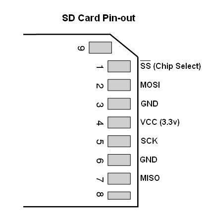

That is it thanks Good Memory Rob. Is that a resistor across pin 5&6 (and what value)? is there a Pinout Diagram anywhere? I Literally have a Ton of those SD card adapters and it would such a good thing if I could use then instead of paying shipping every time I need a SD card slot

Hi Rick,
That component is the decoupling capacitor between 3.3V and GND
You can also use a wired component.
The values is something like 100nf
Posted: 04:37pm 24 May 2022
here are the pinouts on the (full-sized) SD card:
from: http://www.rlocman.ru/i/Image/2010/06/18/4.jpg
rob   :-)
