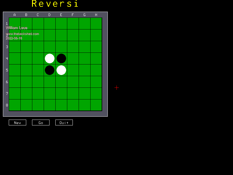

Attached is my Reversi game for the CMM2. It can be played either with or without a mouse. (Othello is the commercial name for Reversi.)
The computer opponent plays a pretty mediocre game; good enough to beat a novice but a seasoned player will have no problem winning. I decided that the alpha-beta pruned minimax lookahead was not pulling its weight so I eliminated it entirely for this version; the computer moves are generated only by policy weights.
Enjoy!
