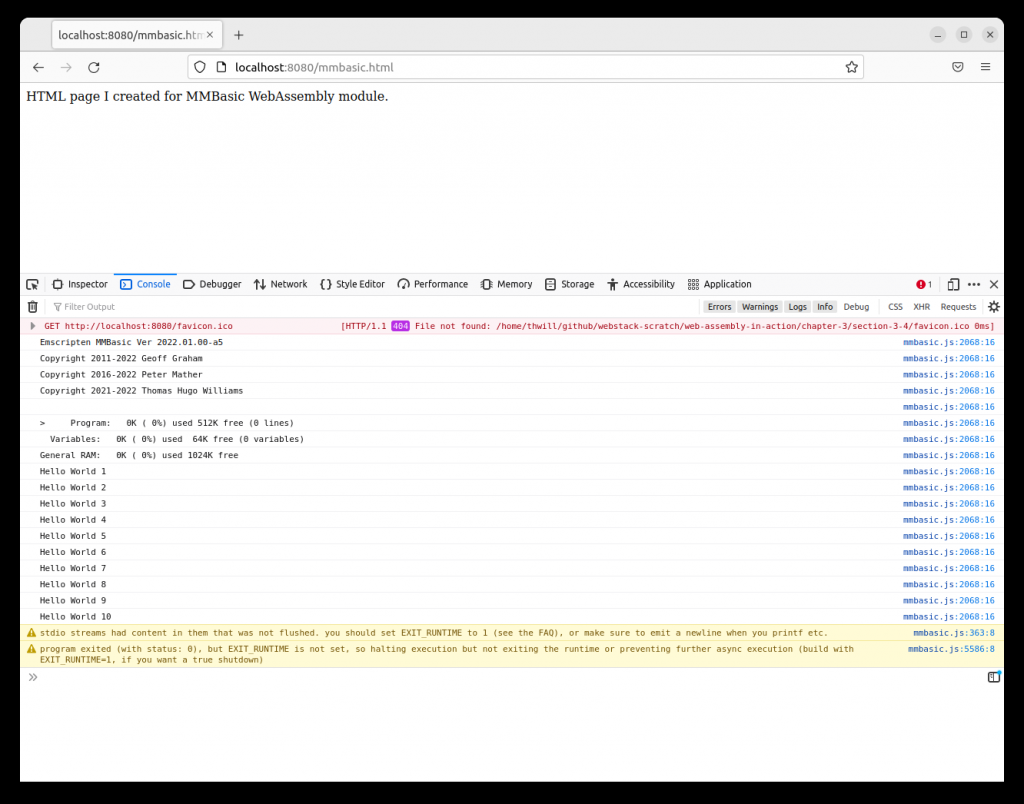

A long way from being anything useful, and I've no idea where I'm going with it (probably nowhere), but this is MMBasic running as WebAssembly within Firefox:

Ah, you have the whole "sandbox" problem there, if that were possible you could write malicious WebApps that could do undesireable things to the hardware attached to the GPIO. WebAssembly runs on the JScript virtual machine built into the web-browser and that VM is very very locked down, even access to local file-system is verboten by default, that's one of the things browser plugins are for, to bypass those limitations.
I suspect what I am playing with is completely bl**dy useless to the main MMBasic/hardware community (and probably everyone else too) ... though it would allow me to host SAAINT on a website .

This is a "self-directed learning" project that I started for the day-job. MMBasic was just a conveniently large piece of C code to work with and had the great advantage that my employers wouldn't then try and sell a half-baked learning exercise as if it were product.
At the moment it is in mothballs whilst I deal with other work priorities. Before mothballing it I had reached something of an impasse as the event loop model that is used for writing Web Applications is incompatible with MMBasic's busy loop. Basically in a single-thread once MMBasic starts running there is no way for the Web Application to render output or capture input. By putting MMBasic into a worker thread you can theoretically deal with the output problem by sending messages from it to the main render thread, but MMBasic's busy loop is still incompatible with the main thread sending input messages to the worker thread. Barring a rewrite of MMBasic's busy loop I think the way forward is using a JavaScript SharedArrayBuffer to communicate between the main and worker threads, but historically these were a security hole and whilst I believe most of those issues have now been worked out, their use may still require explicit opt-in by the user/browser (and possibly the website serving the page).
