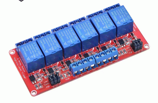

Here is the 6x relay I'm using (it accepts a high turnon):
Module
I haven't specifically traced the circuit, but it appears to have inline SMD resistors marked "102", so 1K. The ground is a return for the opto-couplers which turn on the relays.
There's only one ground to the relay input screw terminal, marked DC-. With 3V3 to the pin marked DC+, the relays wouldn't switch. I connected 5V from the PicoMite, and they did switch, and the PicoMite output pins never show more than 3V3.

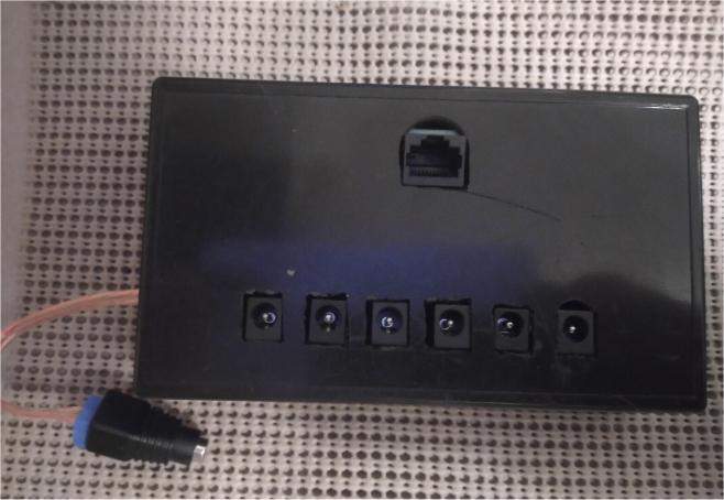

Here's the relay module plus RJ45 PCB plus 6x 5.5mm x 2.1mm power jack PCB in a box. The CCTV plug on the left is for the 24VAC.
I'd never make a living as a machinist. Fortunately, I don't have to.

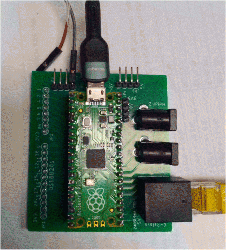

Posted: 11:18am 02 Aug 2022
Here's what it's plugged into (also shown in the video):
Tested against the castellated part of the Pico module not just the pin or the solder joint, with the picomite unplugged from anything. So the problem appears to be on the module. Whether it existed before I plugged it into this board, I don't know--but I had used it before for something--it had an LCD setup in the OPTIONS.

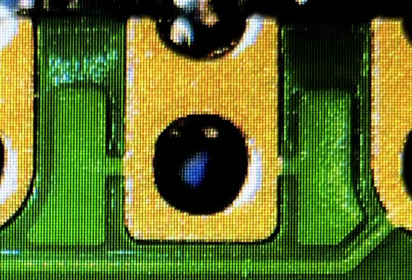

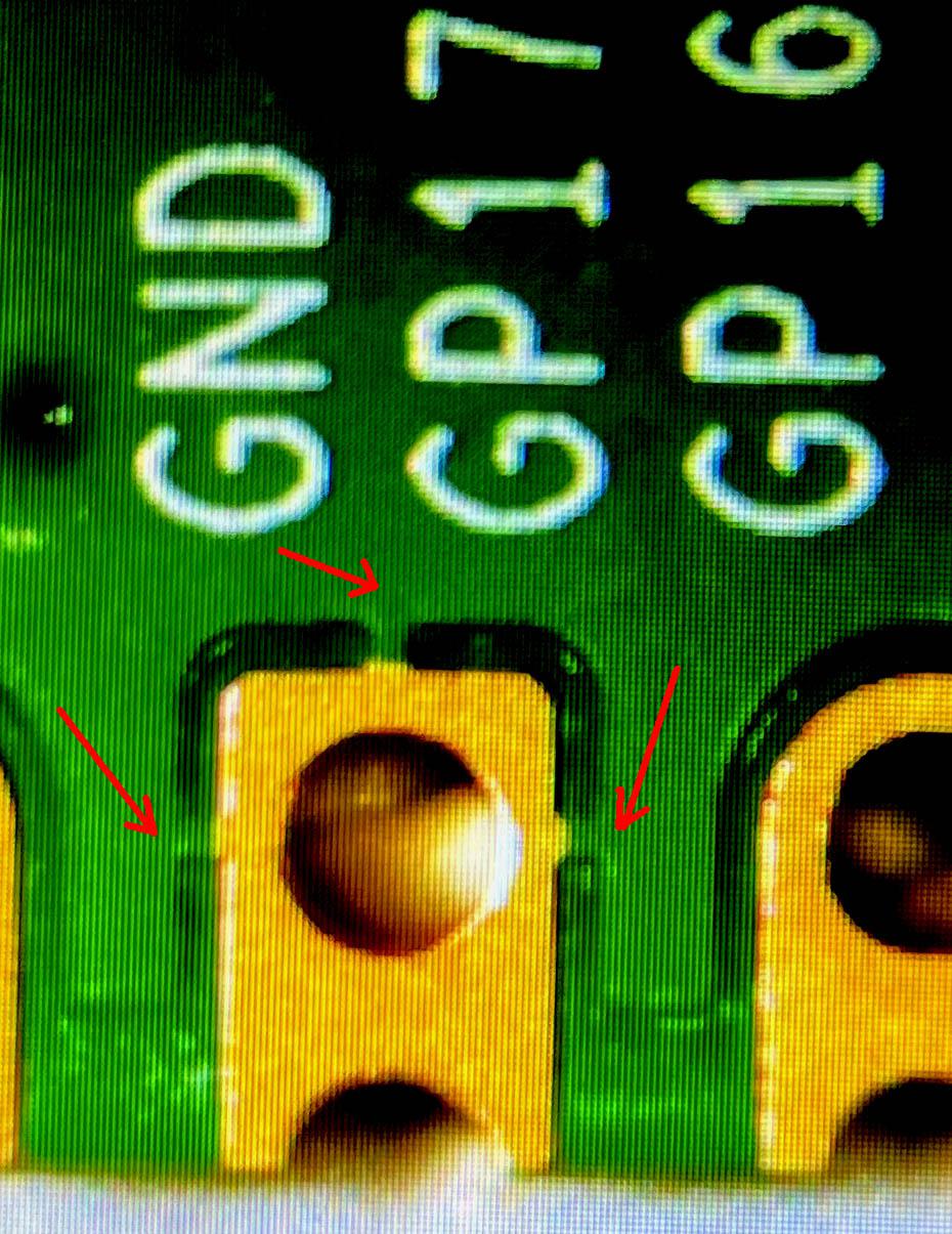

Posted: 04:23am 03 Aug 2022
Hi Lizby, All,
I put one under the microscope to see where the connections to GND are and the top side just connects to 2 isolated/unconnected islands and the Bottom has 3 connections to the Main GND copper pour.
See below, (apologies for the rough images I just took a photo from my Microscope screen)
TOP
BOTTOM
If you have a header pin soldered onto your Pico Pi then you will probably not be able to see the connections to the GND fill.
