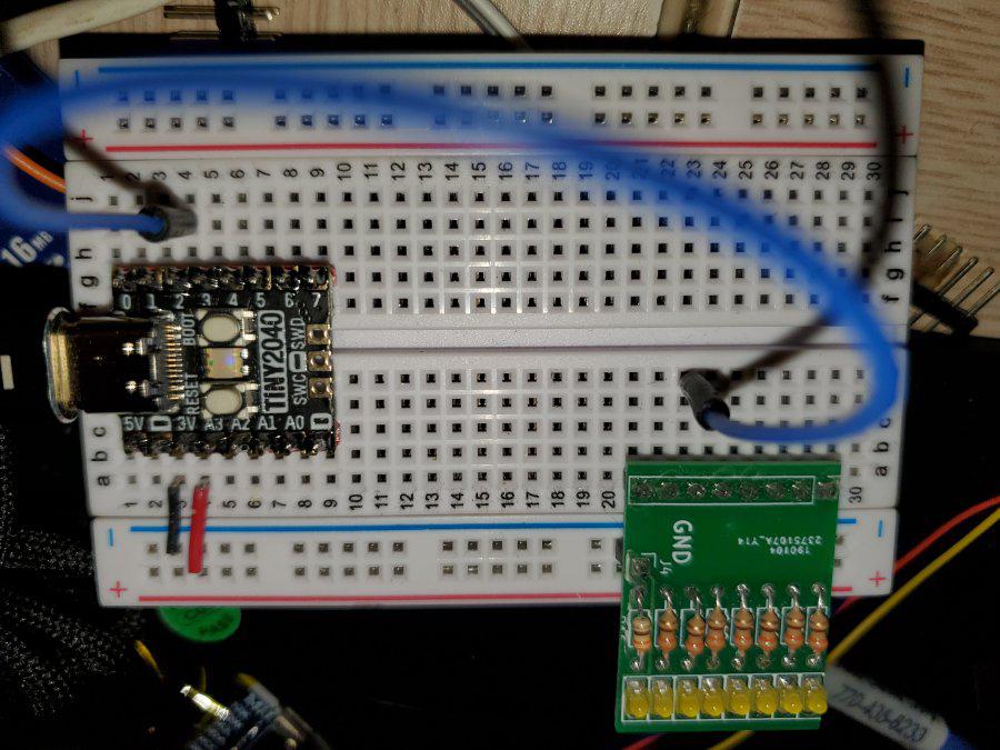

Well, if you are curious... here is my code, as-is. (I managed to break My VT100  stuff by lowercase-ing my codes, no big deal)
' Program:      pulser.bas
' Author:       Pete WIllard
' Version:      0.1
' Target:       picomite
' Date:         2022/08/08
' Time:         09:26:41
' Notes:
' Reference:  Borrowed VT100 Sequences from M. Herhaus code for SOKOBAN
' microprocessor development clock
' 1)  free running fast clock
' 2)  free running slow clock
' 3)  single step
' 4) Exit
'  Goal - using a VT100 Menu
'         -- Allow selection of clock rates for the Ben Eater 6502 project
'         -- Using a Chainsaw to cut butter, but it's cheaper to implement.
'         -- Quick and dirty test... so lazy coding techniques used

 SETPIN GP2,DOUT
'=====[ SETUP ]==================================================================
 PIN(GP2) = 1
 SETTICK slow,clktoggle,1
