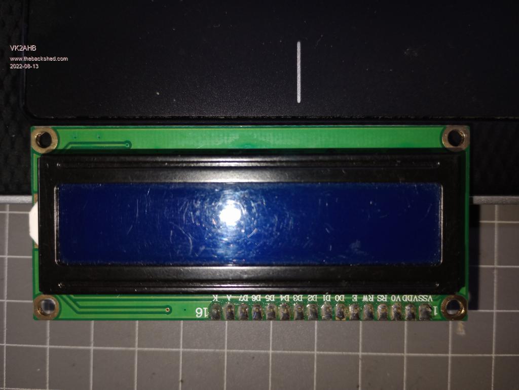

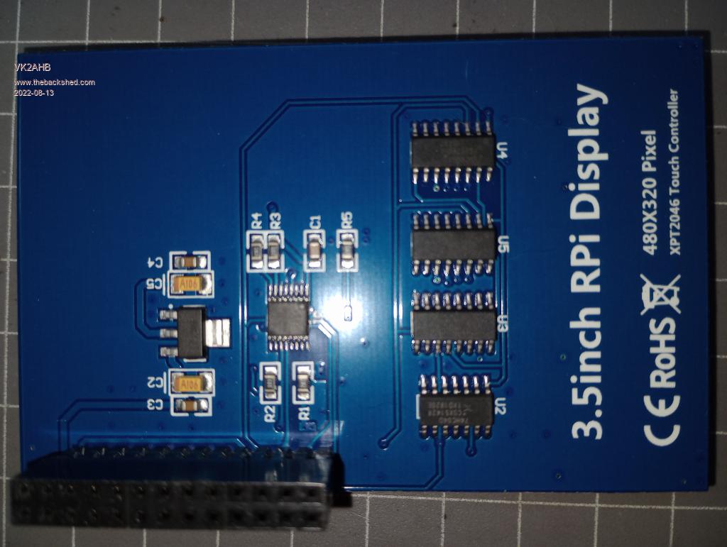

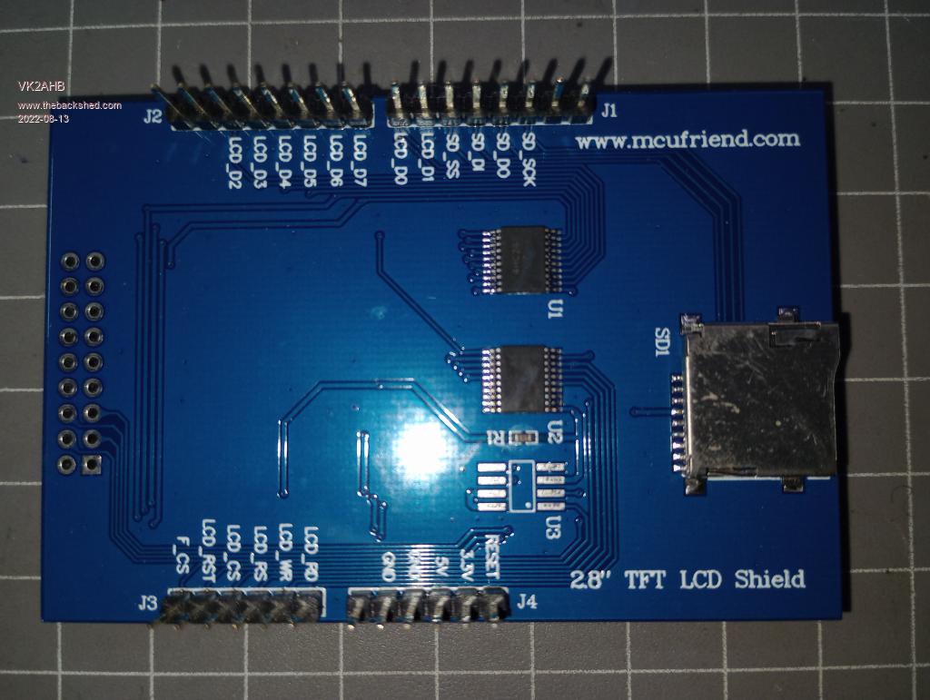

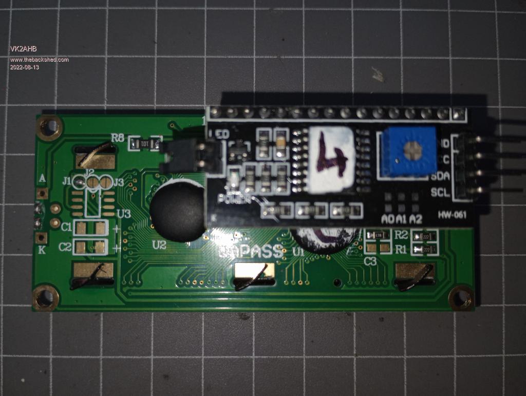

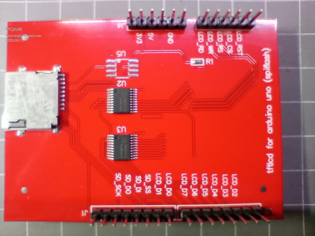

I have a collection of TFT and LCD displays, including a touch screen for the Raspi3B.
The TFTs range from 2' up to 2.8" which I used with the Arduino.
THe LCDs are 2x16 or 4x20 with I2C interface.
Question:
Where can I find examples to use some/all of these?
Can the pico drive the 3B display?
Paul VK2AHB

The picomite manual lists the currently supported display types.
Your first task is to work out what chipset is used on each of your displays.

As you have used them with Arduino you can probably find what they are using it.
