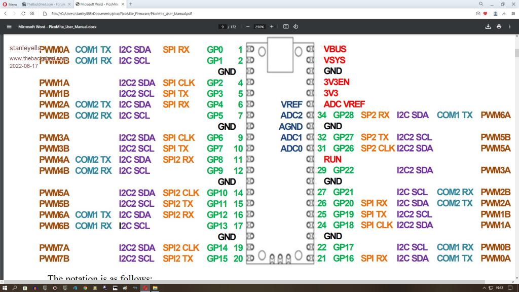

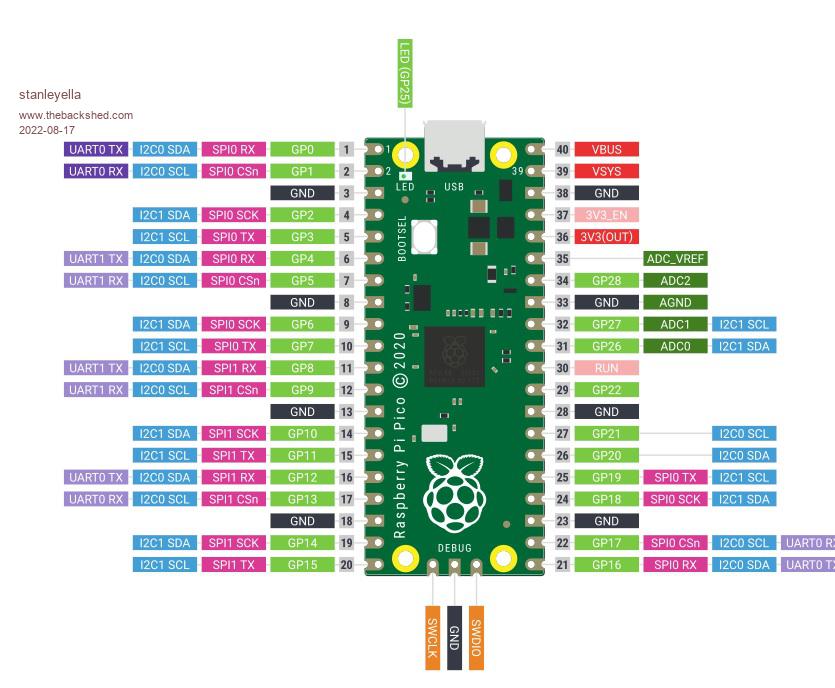

I thought picomite had 2 "hardware" spi.
some basics say bit bang where others say software spi.
I'm wiring a new picomite to another ili9341 and will check the wiring cos touch is shared with the display hardeware spi but not checked the sd card slot... too busy being happy it worked as it was join the dots construction from Geoff's site and his connection drawings.
Posts: 8986
Posted: 05:45pm 16 Aug 2022
That diagram is, to be picky, for the Pico, not the PicoMite. :)
The one in the manual is the one that you need to refer to if you want to get the names right.
There are two hardware SPI ports, referred to in MMBasic as SPI and SPI2, That's to keep compatibility with other MMBasic platforms that only have a single channel called SPI. Using those means that you MUST use the pins shown on the PicoMite diagram.
As I said previously, the SD card is a special case and uses bit-banged SPI. That can use any pins, they don't have to be specified for SPI. It's usually convenient (and pin-saving) to put it on SYSTEM SPI together with a LCD display and Touch though as it only uses one additional pin (for CS) then.
Posted: 06:17pm 16 Aug 2022
OK I'll use the one in the manual
