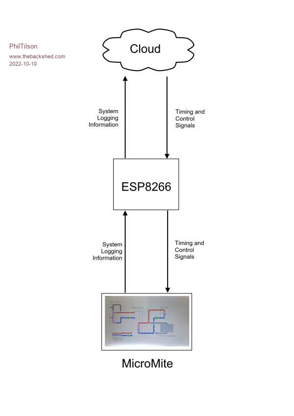

I have a heating control system that comprises a MicroMite Plus as the main processor and an ESP8266 as a link to the internet.  The main processor does all the clever stuff, monitoring temperatures, determining when various valves and pumps should operate etc and the ESP keeps the RTC accurate by using internet time and sends log entries to a MySQL database on my ISP's server.  It also acts as a web server, enabling control of the system from anywhere over the internet.  This is summarised in the diagram.

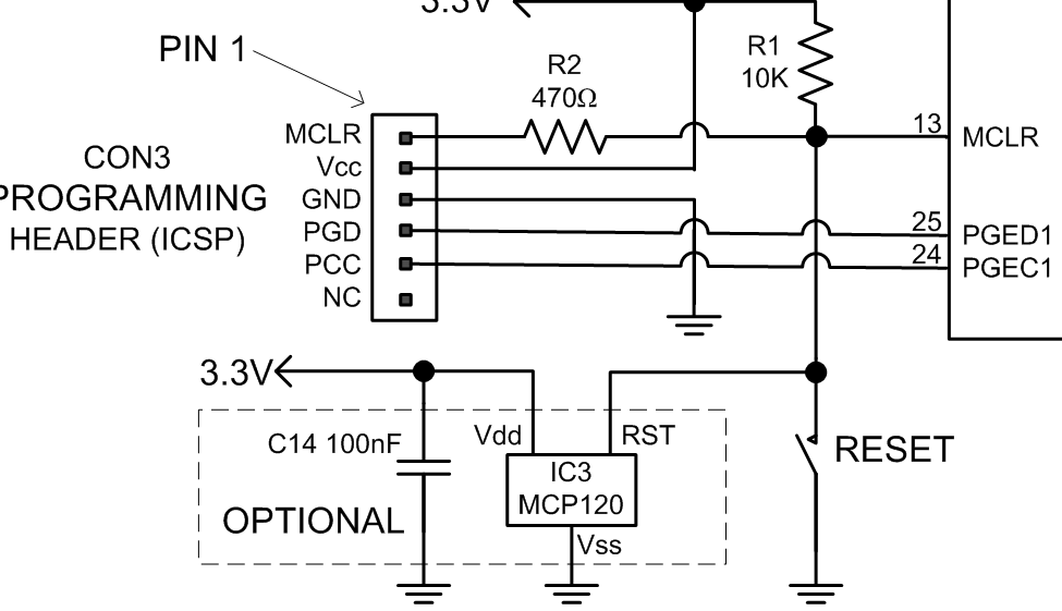

Posts: 6551
Posted: 08:05pm 09 Oct 2022
If it is the explore 100 version, pin 70 is SPI so shouldn't be connected to reset.
Connect to the reset alone and leave pin 70 free to do it's own thing...
The explore 100 has an optional reset circuit included to cater for slow power supply rise time and brownouts.
If your system doesn't' have that addition, now is the time to fit it.
As a final protection, once the external issues have been fixed, use a watchdog in your program, but fix the problem first, or at least, record when the watchdog is activated.
