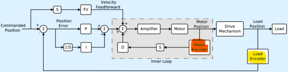

No, the PicoMite is the front-end to my Parallax P2-based motion controller.
The objective is to provide a proper closed-loop-servo alternative to all of these stepper systems
CNC = Computer Numerically Controlled
I regard open-loop steppers: Computer Numerically Commanded
No feedback = no "control".
In fact, my method is to utilize "dual-loop-feedback". The device highlighted in red is what is typical and provides loop stability but the controller is never aware of mechanical backlash. Maintenance personnel can't understand why parts are varying when the controller always reports "axis is within tolerance"
I prefer to use both the red and yellow highlighted devices to provide stability and backlash immunity (within reason).

  Quote  The objective is to provide a proper closed-loop-servo alternative to all of these stepper systems
Have you looked at closed loop steppers? - cheaper than servo technology but with the same guaranteed accuracy with the right driver
Yeah, still too limited.
Torque drops-off at a half-decent speed and they can't get close to the 3,000 - 6,000 RPM that I use.
The biggie for me though is that they can't be torque limited and this is the problem I have with Annin Robotics.
He's doing an amazing job and finally switched to closed loop but closed-loop steppers.
Today, robots are becoming "cobots" (collaborative robots). They can work alongside humans without a protective cage because they are able to torque-limit.
A setup person used to have to use a teach pendant whereas now they can simply grab ahold of the end effector and drag it around and have the cobot learn the path.
This is all achieved by limiting the output of the PID filter.
I have used this method for decades for setting-up my machines. If it crashes, all we get is a harmless "thud".
