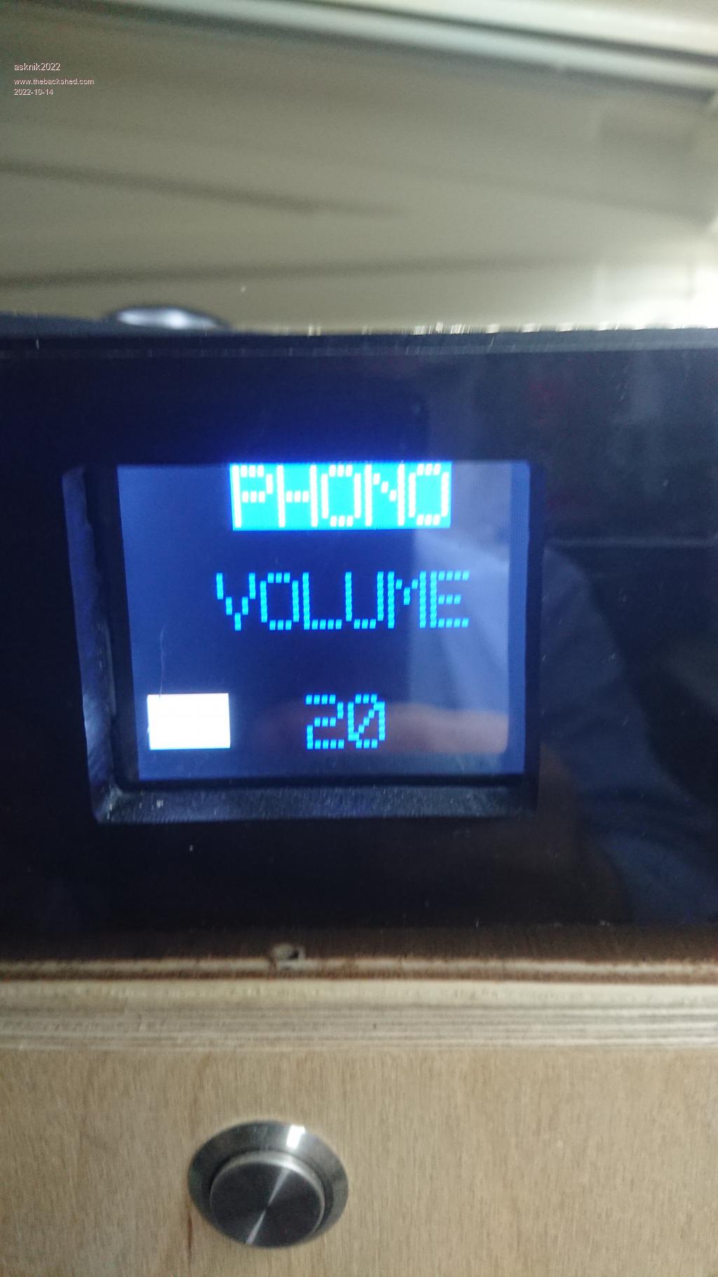

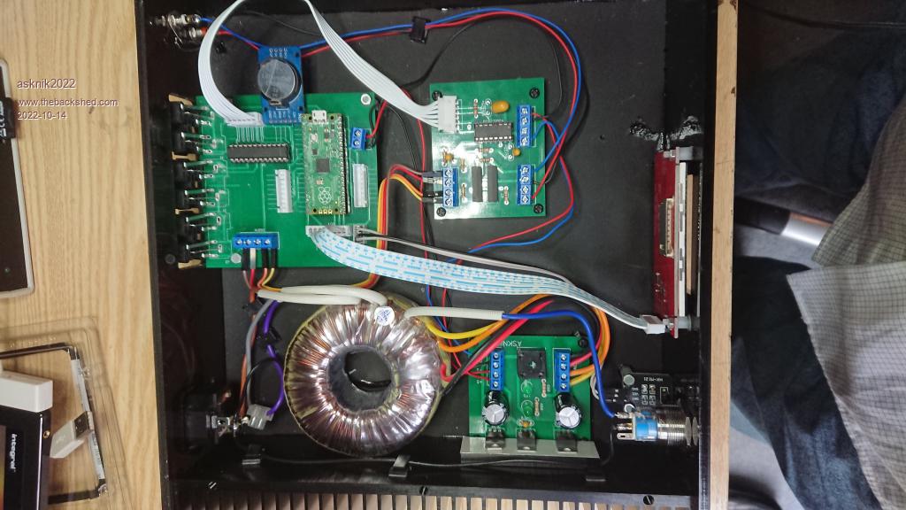

Is anybody interested in the above as I have built one and would love to share etc..

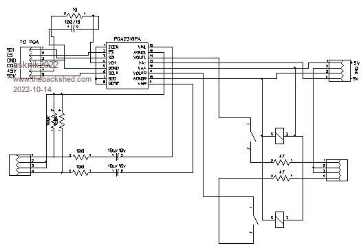

I did one years ago with a couple of Picaxe, one for IR and one to control relays and the PGA. The only issue I had was that the PGA2310 was noisy when used in amplifier mode but worked well when attenuating

Here is my circuit for the PGA2310 and I don't get any noise
