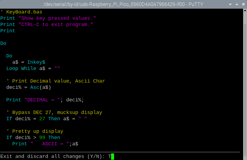

At the bottom of the editor it says "Exit and discard all (Y/N): T".
"Y" kicks you out of the editor removing ANY changes made before saving. "N" resumes normal editing and shows nothing got pasted.

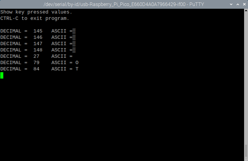

That being said I wrote my own program to capture key presses. My program is similar but it shows the decimal and ASCII characters. Every F key 5 and up to F12 shows the program receiving 3 values with the one key press. The screen shot below was from F1, F2, F3, F4, F5, and behold the mysterious "T" shows up as the last character of 3 from F5. I didn't think KBs did that on F keys.
So Whats happening? I will be trying some other languages to see if this behavior continues. I will try your program as well to see if the results are any different but F5 and beyond all throw an ESC key as the 1st piece of data, which explains the discard message, and the "T" in the input area.

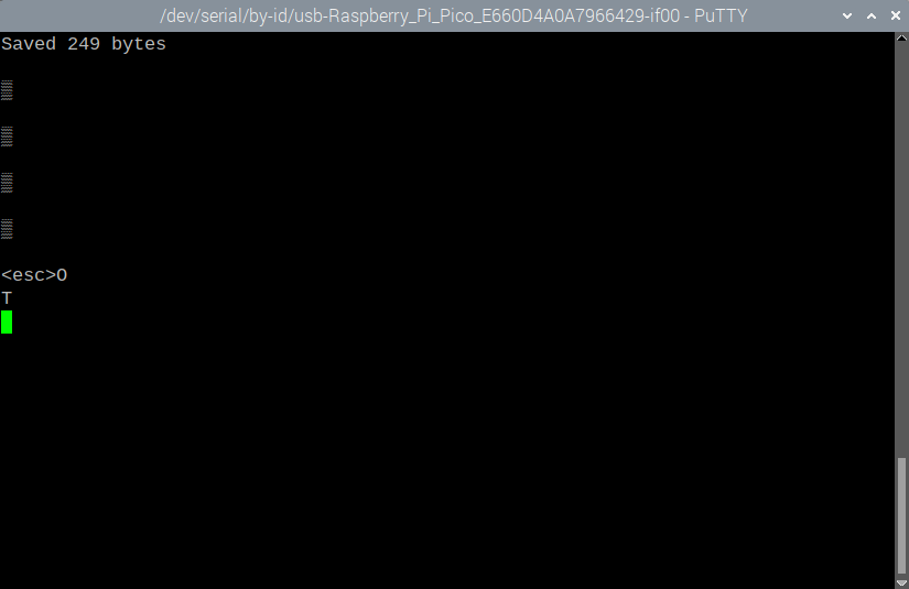

This capture shows the message after F5 is pressed.

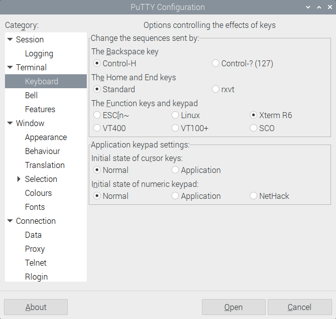

Robert talked about GFXterm so I looked at the putty settings and there is a Function Keys and Pad setting  option to Xterm R6 so I changed it to that from VT100+. The F5 works properly as far as the quick test that I tried.
I should have remembered that the terminal you emulate makes the behavior different.
Again thanks for all the great advice. This forum rocks.
