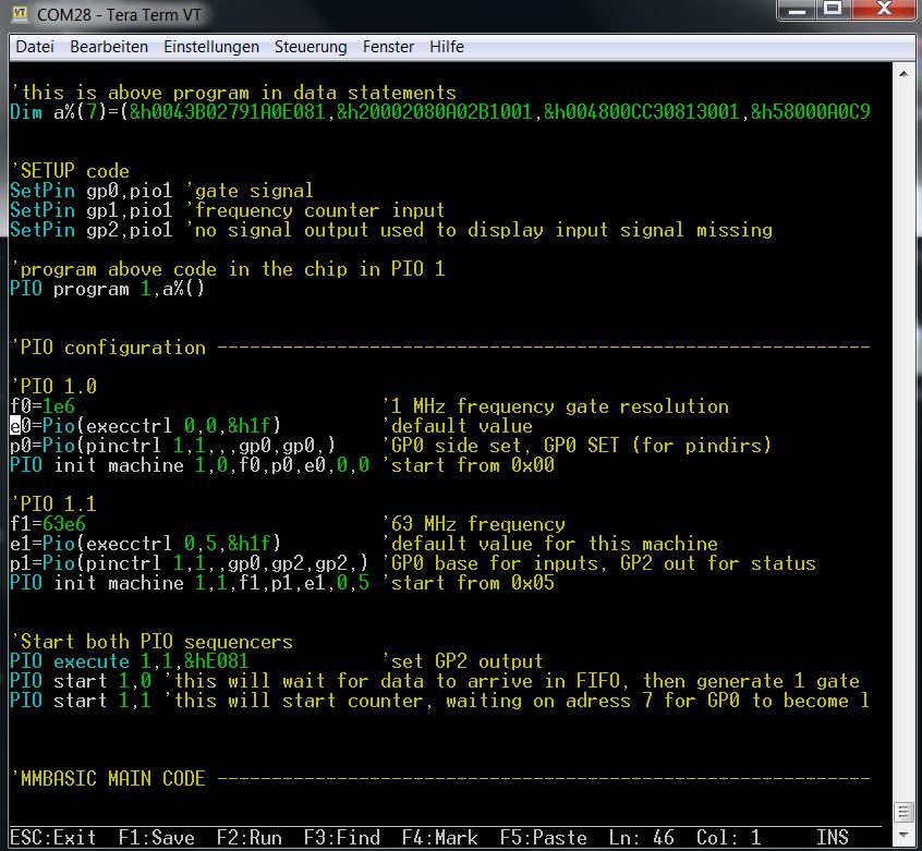

Tested the frequency counter and debugged it. This version is working fine, and shows very accurate frequency readings up to 15.75MHz (PIO 1.1 running at 63MHz).
For my application that is enough.

For those who want to try higher frequencies, you can increase the f1 value (frequency running PIO 1.1). Do not touch the f0 version (PIO 1.0) since you risk loosing accuracy.
Enjoy....
I will use this for the LC meter that Pluto prototyped, to increase accuracy.
P.S. in case there is interest, I would be happy to share the knowledge that I acquired during my hours and hours of studying the PIO and it's capabilities in some sort of written form. Maybe a growing thread on the forum. But just in case there is interest in it. There are quite some differences between the way the RP2040 python world works and the MMBasic way of doing things, so google will most likely confuse you more. Most of the complexity around PIO is in the correct relation between the PIO program and the PIO configuration.

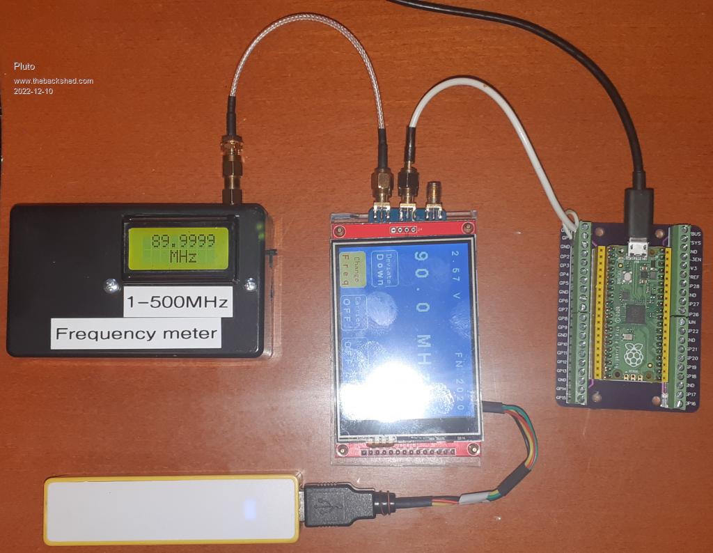

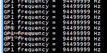

-Using the PWM as input (15MHz). The measured frequency is 15.12MHz measured by your new program and the same result with a purchased low resolution 5-digits meter. In the program listing you say it should be 15.75MHz.
-When using DDS Signal Generator by Geoff https://geoffg.net/SignalGenerator.html, I get at frequencies above 400kHz readings that are 10 Hz high. It is fluctuating between 400000 and 400010. At 3MHz it is 30Hz high. Not a problem at all for me; just wanted to report to you.
-When disconnecting the signal source from the running meter, it continues to show the last measurement. Could be a source for confusion when used in an application. Any possibility to get it to allways show 0Hz without input signal?
Re: PIO-programming knowhow. Yes I would be interested to try to learn...but the chances to pass the exam might however be limited. I am sure there are many others who would be interested in a Picomite PIO-programming Bible.
Thanks!
Fred

#1: the actual frequency from the PWM depends on it's clock. In my case the CPU runs at 252MHz. You may be running a different clock. With 252MHz, the 15MHz command send to the PWM translates to 15.75MHz, which is exactly 63MHz divided by 4.
Important is that what your external frequency counter says is identical to what the picomite says...
#2: need to think on that one. When there is absolute no input clock in the gate timeframe, the PIO code waits forever, and never pushes a value into the FIFO (instruction at address 8 or 9). So the FIFO keeps showing the last valid value. It may need an extra logic signal...
#3: that is why I ask. Don't want to spend a lot of time when no-one even reads it.
About the DDS generator: the gate time in my code is 0.1second. That measn that fluctuations between 400000 and 400010 are actually only 1 count. Change gate_time to 1, and you will get more accurate results.
Edited 2022-12-09 23:48 by Volhout

Hi Volhout.
I found an easy way to get 0Hz reading when signal input is removed. I just provide the input GP1 with a low frequency signal. Just put a 100k resistor from GP1 to GP0, which your program already a low freq output on. This resistor can be permanently connected. It does not seem to disturb the measurement when you have a signal source connected.
If you do not wish to have the resistor and you have cables connected to the GP1 when you remove the signal source, the cable will pick up 50Hz from the surroundings and output 50Hz. This value is of course not zero, but it will be an indication of a missing signal source.
Posts: 6184
Posted: 07:26pm 09 Dec 2022
Hi Pluto,
Please find attached code that shows "no input signal".
When the PIO 1.1 is stuck waiting for signal, it leaves pin GP2 high. The basic program checks for this, and shows text.
Note that GP3 is the PWM signal to provide the test frequency (not GP2).
This fix is possible due to Peters fix, that allows to read a POI assigned pin (setpin xx,pio) in the basic program, even when it is not assigned an input.
Thanks Peter !!

'Frequency counter using RP2040 PIO
'PIO machine 1.0 generates a progr. gate signal on GP0 (side set pin GP0)
'PIO machine 1.1 uses the gate signal to count GP1 pulses
'PIO program and configuration ------------------------------------------------------
'PIO 1.0 (gate)
'adress data   mnemonics                         comment
'  0    E081   set pindir 00001                  'set GP0 to output
'  1    91A0   pull block .side(1)               'pull data from FIFO into OSR when available
'  2    B027   mov(x,osr) .side(1)               'load gate time (in clock pulses) from osr
'  3    0043   jmp(x_dec, this line) .side(0)    '1 cycle count down + gate low
'  4    1001   jmp 01 .side(1)                   'loop back
'PIO 1.1 (count)
'  5    A02B   mov(x,-1) .side(0)                'x = -1
'  6    2080   wait(1,pin,0) .side(0)            'sync
'  7    2000   wait(0,pin,0) .side(0)            'detect falling edge of gate
'  8    3001   wait(0,pin,1) .side(1)            'wait for risig edge pulse
'  9    3081   wait(1,pin,1) .side(1)            'wait for falling edge pulse
'  A    00CC   jmp(pin, pc=0x0c) .side(0)        'continue counting ?
'  B    0048   jmp(x_dec, pc=0x08) .side(0)      'yes, count next pulse
'  C    A0C9   mov(isr,-x) .side(0)              'copy counter to isr
'  D    8000   push noblock .side(0)             'get value to FIFO
'  E    0005   jmp 05 .side(0)                   'prepare for next gate pulse
'this is above program in data statements
dim a%(7)=(&h0043B02791A0E081,&h20002080A02B1001,&h004800CC30813001,&h58000A0C9,0,0,0,0)
'SETUP code
setpin gp0,pio1          'gate signal
setpin gp1,pio1          'frequency counter input
setpin gp2,pio1          'no signal output used to display input signal missing
'program above code in the chip in PIO 1
pio program 1,a%()
'PIO configuration -------------------------------------------------------------------------
'PIO 1.0
f0=1e6                            '1 MHz frequency gate resolution
e0=pio(execctrl 0,0,&h1f)         'default value
p0=Pio(pinctrl 1,1,,,gp0,gp0,)    'GP0 side set, GP0 SET (for pindirs)
pio init machine 1,0,f0,p0,e0,0,0 'start from 0x00
'PIO 1.1
f1=63e6                           '63 MHz frequency
e1=pio(execctrl 0,5,&h1f)         'default value for this machine
p1=Pio(pinctrl 1,1,,gp0,gp2,gp2,) 'GP0 base for inputs, GP2 out for status
pio init machine 1,1,f1,p1,e1,0,5 'start from 0x05
'Start both PIO sequencers
pio execute 1,1,&hE081            'set GP2 output
PIO start 1,0 'this will wait for data to arrive in FIFO, then generate 1 gate
PIO start 1,1 'this will start counter, waiting on adress 7 for GP0 to become low
'MMBASIC MAIN CODE --------------------------------------------------------------------------
'generate a test frequency on GP3, for testing of the counter
setpin gp3,pwm
pwm 1,15000000,,50                 'change 15000000 to test different frequencies.
                                  '15MHz PLL generates 15.75MHz dues to divider settings inside the PLL
'variables and constants used in the counter
dim r%(3),c%                        'define variables, r%() only used to empty fifo
gate_time = 0.1                     'seconds
gate_clocks% = gate_time*f0 - 1     'for 1MHz PIO gate clock as integer (n counts (n-1...0))
'this loop does the actual counting
do
 if pin(gp2)=1 then
   print "no input signal"
   pause 200
 else
   'put gate time in PIO 1.0 OSR (gate time is specified in PIO cycles, could be 1MHz, 10MHz..)
   pio read 1,1,4,r%()               'empty fifo from rubbish (only needed at start)
   pio write 1,0,1,gate_clocks%      'this starts the gate pulse generator, single pulse
   'wait gate time + few ms for printing data
   pause (1000*gate_time + 200)
   'get FIFO value
   pio read 1,1,1,c%                 'read value from FIFO (there is only 1 value in it)
   c%=c%/gate_time                   'convert or Hz
   'print frequency value
   print "GP1 frequency = ";c%;" Hz"
 end if
loop

Volhout, some more testing of your latest PIO code ......
@CPU378MHz, f1=378e6, pwm 1,90000000,,50:
94.5MHz "confirmed" by FM-radio. 10cm wire on the GP3 makes an FM transmitter with receivable signal >10m indoors.
An other frequency meter (cheap) also shows 94.5015MHz.
