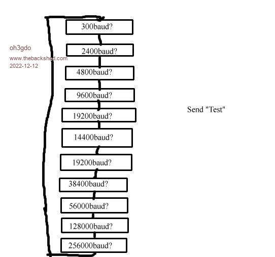

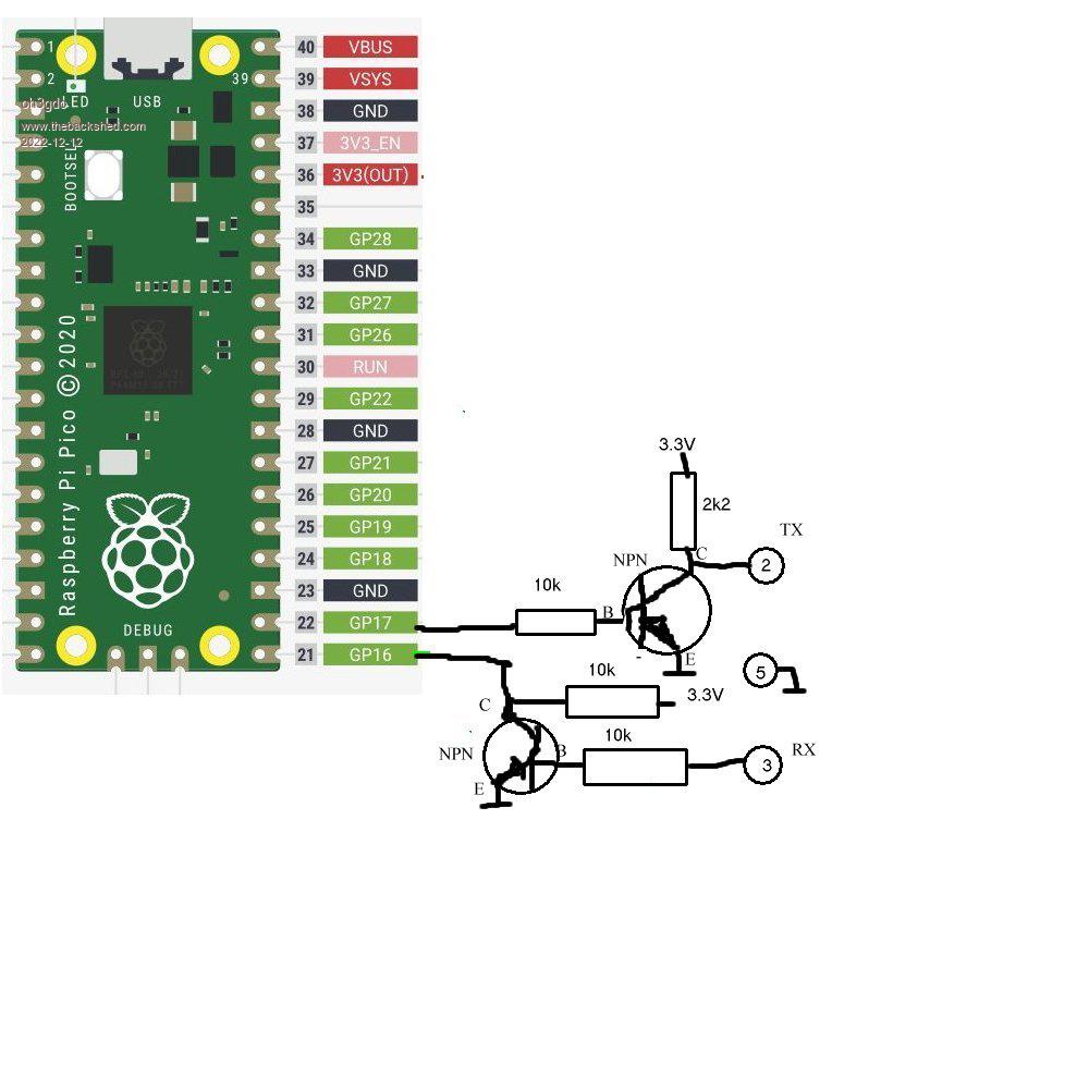

I have a separate suggestion.
First build your own RS232/TTL converter.
You need 2 NPN transistors an few resistors.
Then made a test program, which looks if you get right answer.
Look what you get from your test program.
I have done so about 50 years
Pekka

For a sniffer you typically have only RX (sometimes 2x RX) to spy on existing communication. You do not need TX out.
The RX circuit (the NPN transistor and 2 10k resistors) is enough.
If you sniff, you have no control over the data on the bus, and you cannot force data (like "test") on the bus. That is why you need to analyze the activity, and determine the shortests pulses, these are most likely 1 bit time long.
