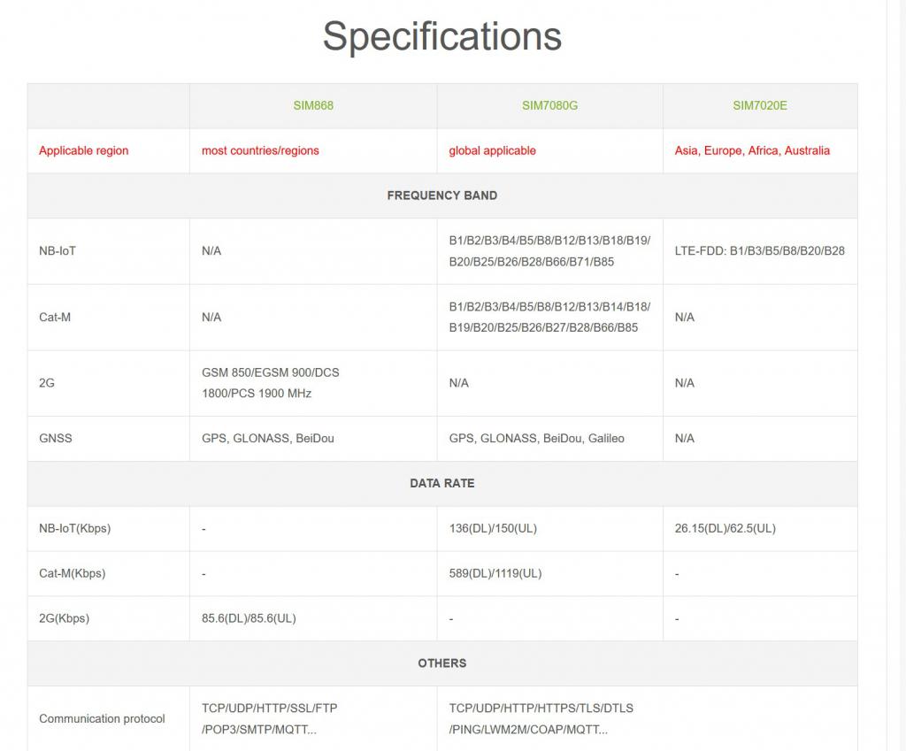

2G SIM but that's all I can contribute

  Tinine said  2G SIM but that's all I can contribute
Where did you get 2G sim from?
it's 4G LTE

Yes, Lew, you are right or wrong. :)
Not sure how you derive 4G from that spec...  Mind you, I know nowt about this stuff so that's hardly surprising.

I think the answer (for 4G in the UK) may be B20 (800MHz) & B3 (1800MHz). If so, the OP is OK.

I just saw the 2G stated. I had a tracking device for my dog and it would only work with a 2G SIM.

I actually meant communication over the phone network using the sim
I know it's 4G because the UK uses mostly B1, B3 and B20
and it's an LTE device
I meant talking to it, is it as simple as using http get and http post using the uart port GP0, GP1 and GP17 to wake the module and GP14 to shut down the module

On the device " 4g modem" listed above it lists its sim card slot as only supporting
a NB-IoT / Cat-M card (1.8V ONLY)

Actually, choosing a SIMCOM module that will work on your country's cellphone network can be something of a technical nightmare.  At least it USED to be, but now, basically from 4G LTE onwards, the entire planet seems to have standardized cellphone bands and frequencies, which makes modules that work anywhere much more easily producible.
Prior to that, 2G and 3G could be on any one of a plethora of frequencies, depending on what that specific country decided to assign it's network to, which meant that you had to make sure you chose a module with the correct suffix to work in your country, or the frequency bands would be incompatible, and the bloody thing would simply refuse to talk.
Yes, I speak from experience.
Thankfully, these daze, that has changed and you are much more likely to find that any given module will work on your cellphone network, provided you make sure you select the global variant, as it will have all the global standard frequencies in it.
The SIM7080G module used in this Waveshare module, SHOULD work anywhere in the world, as it is a global module as far as IoT is concerned.  Without downloading and reading the datasheet for the 7080G(which I might do later), I don't know if it would support SMS/text messaging on the 3G or 4G LTE networks, so sending text messages to cellphones is something you might need to check up on, but at first glance this is NOT supported, just the IoT data stuff.
