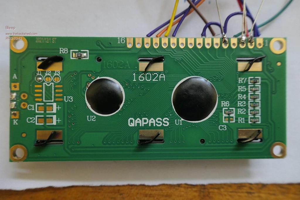

Hi, I'm trying to drive one of these 1602A LCD devices :-
BITBANG LCD INIT GP8, GP9, GP10, GP11, GP6, GP7
BITBANG LCD clear
BITBANG LCD 1, 1, "Hello World"
It claims to use the HD44780 driver chip, however I am failing to drive it, does the display have to be a 3.3V device? in the diagram in the manual, it shows 5V supply, I did in fact order a 3.3V and this one arrived however on further investigation, I think it is 5V, though it is not entirely clear how you tell?
I have checked the outputs from the Pico and all of the EN,RS,D7,D6,D5,D4 signals are toggling in what appears to be a sensible way when the display is driven.
Any suggestions?
Regards, Kevin.

This code works for me "out of the box" with a Picomite, direct from Commandline
In most cases it is wrong cabling, wrong (missing) contrast Potentiometer.....
Powered with 5 Volt from the PICO.
Bitbang LCD INIT GP2,GP3,GP4,GP5,GP6,GP7
Bitbang LCD 1,1," Hello World"

1/ You have the contrast set with fixed values (fixed resistors). That could be a problem, since there is quite some spread between displays (I use a potmeter, and sometimes it is really over to one side).
2/ No backlight. May makke it more difficult.
3/ The ones I have used are all 5V.
4/ Check if you have a swap in the datalines. For the text on screen: you will just see  different characters, be before the text is shown, the same 4 data lines are used to configure the display (config depending RS pin level). A swap in datalines may cause wrong configuration of the display.

Particular thanks to Volhout, again, you were quite correct, it was the contrast and yes it had to be set right down to almost ground, then suddenly the display appeared. :-)
Thank you very much.
