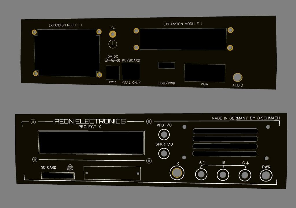

My plan with this PCB project and the attached VFD is to have an "alround" PicoMite, which can be a base for all kind of projects. This is why I call this interation of PicoMiteVGA "Project X".
3 Buttons, a VF-Display (cool retro stlye) an integrated amplifier with speaker and the GPIOs are INTERNAL for a good reason. I left much space so one can integrate additional PCBs.
On the backside panel I left two "expansion module" slots, so you can mount whatever you want into / onto it. I already built a radiation counter with a geiger tube; this is one application, for example, to fit in.
Materials:
Case: I used the bigger brother of the "offical" picoMite enclosure called "Gainta G716". It is good available, even in europe (tme.eu).
VFD: Samsung HCS-12SS59T VFDisplay (available at Pollin.de for just 1.75€)
Speaker: "MATSUsh*tA Kleinlautsprecher G7D506B2 " (available at Pollin.de for just 0.95€)
May all this inspire you for own projects, I've attached you all my design files here, even the raw PCB files, so you can modify it of course:
