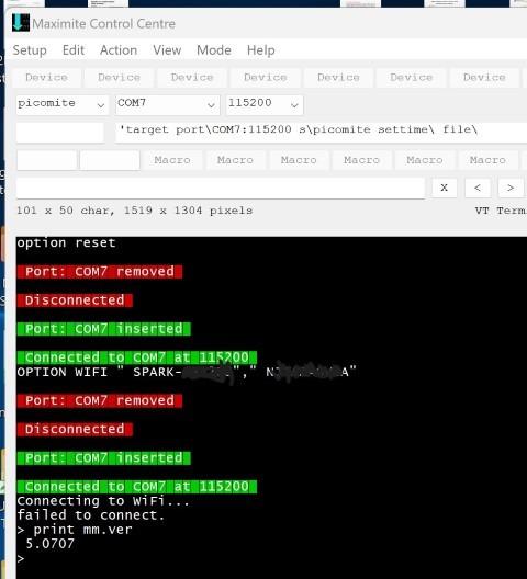

Can anyone tell me what is wrong here?
I am using WebMiteV5.07.07RC2
The WIFI Router I am trying to connect to has an SSID and and SSID(5G). Which one should I be using?
I have referred to the manual posted by Pete Willard and the "Lessons" by LucV  .

Are the leading spaces meant to be there?
OPTION WIFI " SPARK-......."," N........"

The leading spaces within the quotes do look suspicious.
Use the 2.4G band SSID
Case is important.
Your router might be a bit fussy like my FritzBox.
The first connect attempt always fails. A CPU RESTART or reset button and all is good the second attempt.

Looks like it was the space between " and SPARK.
