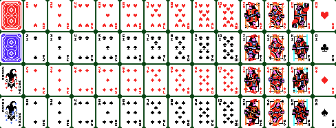

I'm working with a new set of card images based on these from Michael B. Myers Jr, which were designed for the Pico8.
(This version has already been colourised to the PicoMiteVGA's palette.)
The non-picture cards would be much easier for you to create.  The picture cards, however, have many more colours.
