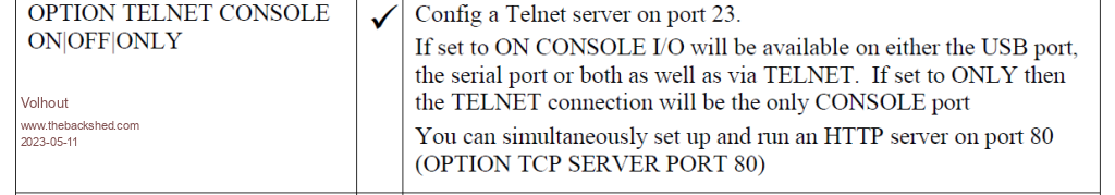

In options you must enable telnet.
Then you should connect through IP address (I used Putty, never used Teraterm for Telnet.)

I should have mentioned it, I do have telnet enabled (ON).

I was just about to give up when it hit me like a freight train, I forgot to re-enable the option telnet console after resetting the webmite options...
Well, it works now.
