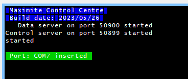

In W11, right click on start button and select device manager.
But there is no need.
Start MMCC
plug your micromite in and MMCC will tell you which port just arrived/departed.
Peter
Joined: 27/05/2023
Posts: 2
Posted: 06:35am 29 May 2023
Thanks Jim - that works.
