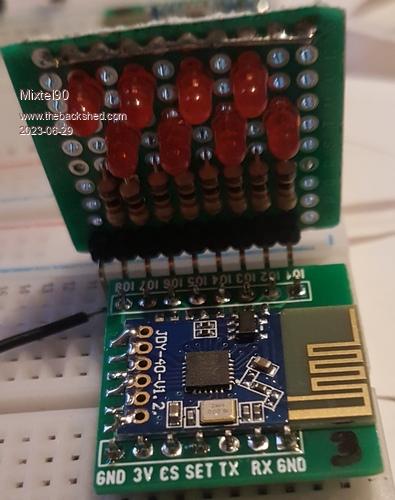

These things are fun, not to mention stupidly cheap from AE. :)
I just fed the 8 GPIO pins of a JDY-40 to 8 GP pins of a RP2040-Zero and set the system up so that the PicoMite counts up on the PORT. The JDY-40 sends the data to another one connected to LEDs. With the transmit power set as low as it will go and the baud rate set to 19200 (the maximum) it's just losing signal with the transmitter at the front of the house and the receiver at the bottom of the back yard if I put it close to the wall. Easily enough power to cover a room or two in many cases. I'll re-test the range with text data later.
