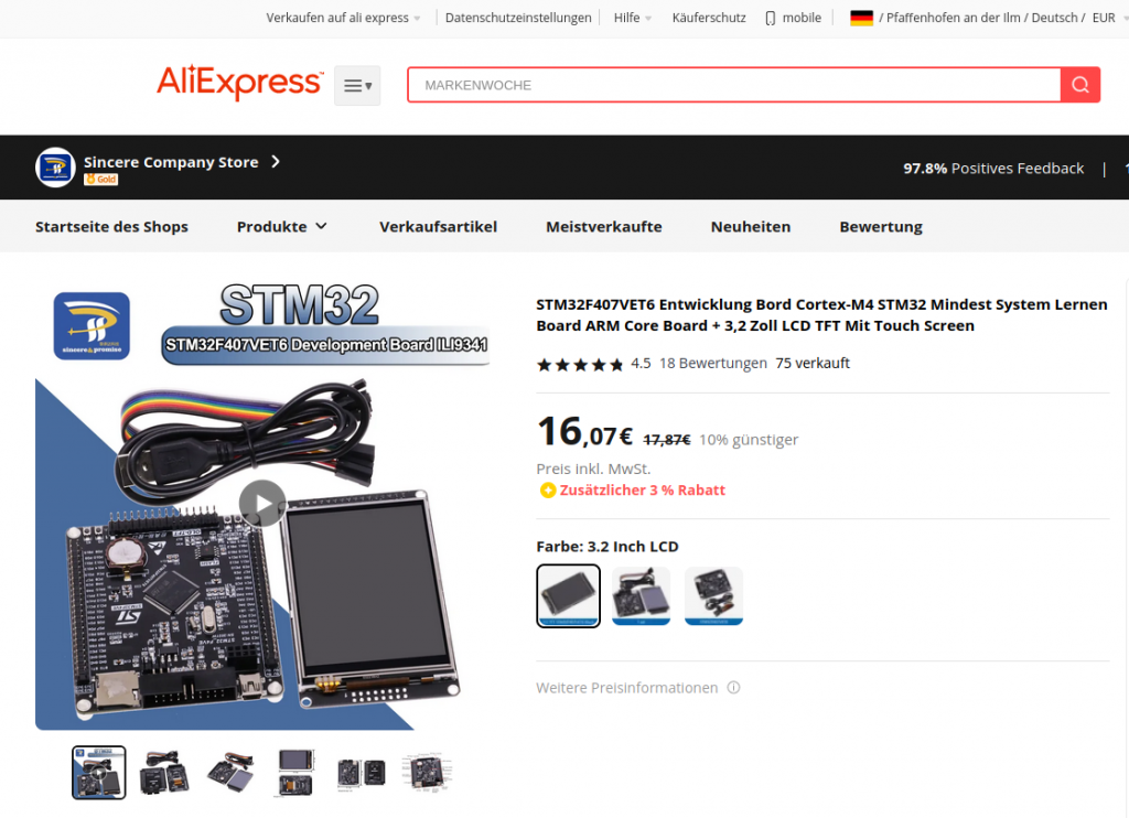

Thank you for the tipp ;-)
I payed 11,56 € for the first order. On the picture is the price shown, when I visited the site a second time. The display is included!

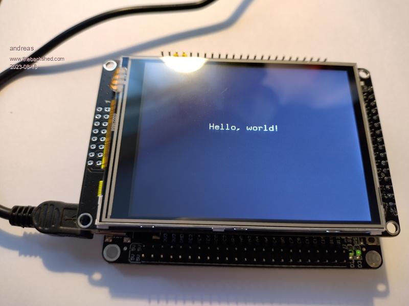

The board (STM32F4VE) arrived today and works:
> option list
OPTION COLOURCODE ON
OPTION DISPLAY 50, 100
OPTION LCDPANEL ILI9341_16, RLANDSCAPE
OPTION TOUCH PB12, PC5
GUI CALIBRATE 0, 355, 205, 944, 668
> memory
Flash:
  1K ( 1%) Program (2 lines)
131K (99%) Free
RAM:
  0K ( 0%) 0 Variables
  0K ( 0%) General
151K (100%) Free
> list
CLS
Text 100,100, "Hello, world!"

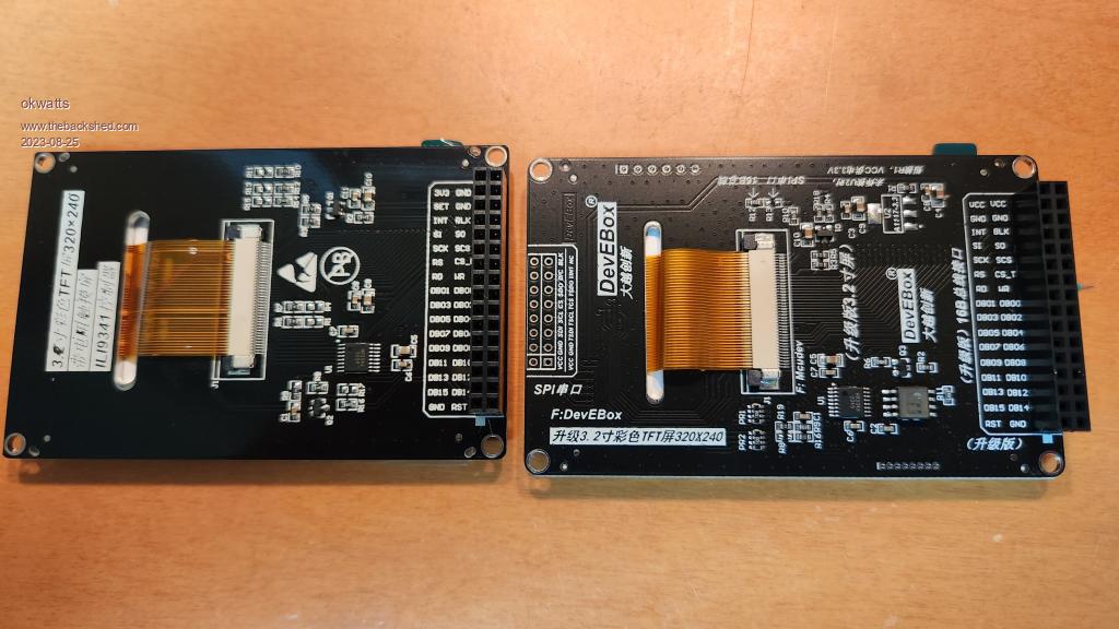

I just received 2 lcds from aliexpress (different stores) one of which is from the store you apparently ordered from. I thought I was getting both the development board and the lcd for $22.88 CDN with shipping. It turns out that was just for the lcd. I also ordered just the LCD from ACELEX $13.42+4.53 shipping =17.95 CDN including the shipping. Apart from feeling I was deceived in the advertising by the Sincere Company Store version, the 2 LCD's are different in the connectors as shown in the photo. The one on the left from ACELEX matches my old v2.1 dev boards but the other has some significant differences in the power and gnd at the end of the connector. If I had actually got the development board I thought I was getting it would hopefully have paired with the LCD correctly.
I assume yours came as a pair and are operating nicely, but Its buyer be aware apparently.
This was noted by flip in the thread "ArmmiteF407 V5.07.01 betas - lots of new stuff"
https://www.thebackshed.com/forum/ViewTopic.php?FID=16&TID=16148 regarding newTFT and OLD-TFT.
