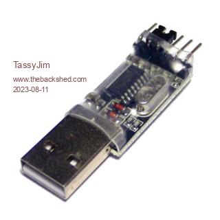

I use CH340 USB-TTL modules a lot.
They have been reliable and easy to drive. Until now.
I discovered that MMEdit no longer liked some of my modules.
TeraTerm was OK but not MMEdit.
The module in question is this one.
The description on one local suppliers web site is:
  Quote  CH340G USB A to serial adapter module, ideal for interfacing a USB to a micro-controller serial RS232.  USB power can be set to either 3.3 or 5vdc with an onboard link.  Uses a clone CH340G chip that is fully supported by most computer operating systems. Please Note: that there are reports that some newer drivers many not work on all operating systems.
They work OK on my W10 PC but not my W11 system.
Linux seems OK
I did work out a fix for MMEdit fortunately.
I open the port as 2400 baud first then close the port and reopen at the required speed. So far that has been reliable.
Buyer beware...

Try installing an older driver in W11.
This happened to FTDI drivers also, where latest driver refused to work with chinese clone chips.

  Volhout said  Try installing an older driver in W11.
Users of MMEdit would not like me telling them they have to fix their computer, probably after every Windows update.
Much better if I can fix it for all users without them having to worry about it, which I seem to have done. For now.

WCH supply the driver, not Microsoft.
It is possible that they did what Prolific and FTDI did and deliberately stuffed the clones.
It is also possible they they just stuffed up.

99% the win 11 driver be the problem, try install the Chinese driver normally the vendor say a link when you buy it in aliexpress. maybe the windows or the browser say it be a virus, 99% is not.

Indifferent to my personal taste, the problem is probably in the win 11 driver.
I didn't post to say that one system is better or worse, but to present a possible solution by installing the driver over the win 11 native.
Especially if you see that in win 10 it worked and in 11 it didn't.

I came across the problem and thought that other TBS members might save a lot of head banking if they were aware of the 'problem'
To finish my contribution.
This code runs OK in MMb4W on my W11 PC but requires the additional kick start in the original MMBasic for DOS.
PRINT "started"
OPEN "com8:2400" AS #2  'these two lines are need in MMBasic for DOS
CLOSE #2                ' but not for MMB4W
OPEN "com8:38400" AS #2
PRINT "port open"
PRINT #2, "help"
PAUSE 1000
reply$ = INPUT$(200,#2)
PRINT reply$
CLOSE #2
PRINT "done"
I believe it was an update to Windows that occurred on 8th August that started the issue.
