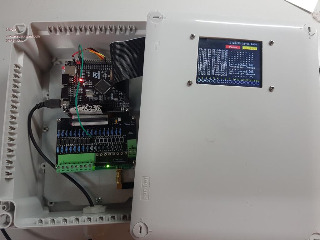

Glen, I have done this before and you cannot use IDC connectors both ends as unlike say a floppy drive or hard drive the pins are reversed on on connector to the other. The only successful way I have been able to accomplish an extension cable is to use an IDC one end and individually solder a header strip to the other end. I will try and find a photo and post it.
Hopefully this helps.

Sorry this photo isn't that clear and only shows the IDC end of the black ribbon cable but it does show that it can be done.

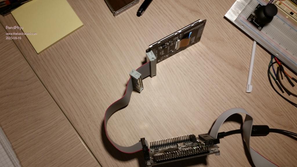

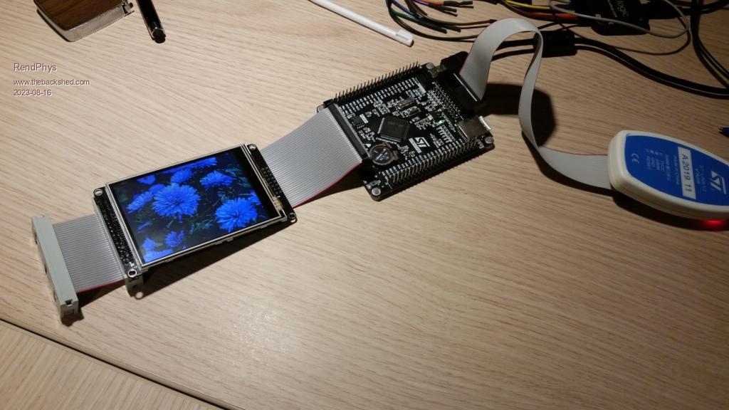

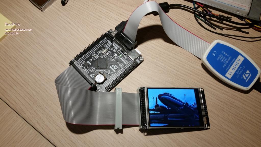

I do indeed use the IDC cables and connectors to position the LCD on any wanted position.
As far as I know there are no 32-pins standard cables, so I use the 34-pins variant. Be aware of the proper positioning of the (unused) pins, so indeed the proper pins are connected. Can be easily verified using an ohm-meter, of course.
Some links to start searching:
https://www.aliexpress.com/item/4001244049708.html?
https://www.aliexpress.com/item/33029492417.html?
Here some pictures of how it can be done...
