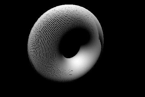

Posted: 02:40pm 17 Aug 2023
On a 480x320 ILI9488 by a picomite, with BMP file converted to JPG:
