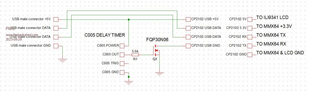

My circiut looks like this:
A much smaller FET shold have been sufficient, but this is just a testcircuit.
As you can see it puts also the LCD into SLEEP.

The MicroMiteExtreme 64 and the connected LCD switches ON/OFF/ON/OFF.... and displays properly.
The only problem is that console prints OK numbers after some start-ups and rubbish after other start-ups. Can it have something to do with that the power is cut on the GND line to CP2102??
Would of course be nicer to cut the power on the +5V line to CP2102, but probably some more components?

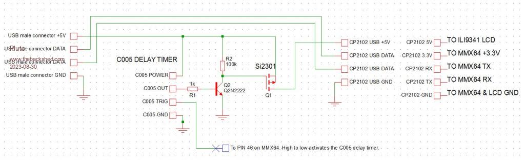

  Quote  Otherwise the output of the N-channel FET can drive a P-channel FET in the 5V line.
Just tested with P-channel FET in the 5V line. Works much better!
