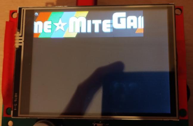

I'm trying to show a JPG on the PicoMite:
Cls
splash.zip
And the result is even less satisfactory than the photo :

same result,
even  if I copied it to a 320x240 Picture ...
As long as it is jpg, picture looks terrible,
but BMP works as expected

Results vary depending on the image editor. Got best result with IrfanView but still a narrow strip moved from RHS to LHS.
It seems there are different ways to encode a JPG but this decoder can't cope with them all.
A work-around would be to first reverse-butcher the image so the decoder restores it.  ;)
Or use Blit to rearrange it.

There is a bug I introduced in the jpg decoder when I got rid of a bunch of compilation warnings. In addition, sorting this led me to another day 1 bug when the image isn't either bigger than the screen or an exact multiple of 8 or 16 pixels wide.
Finally, the splash image is crap with varying pixel levels in the flat colour areas which result in a spotty image - that one isn't my fault.
My bugs will be fixed in RC20 when posted.

  matherp said  There is a bug I introduced in the jpg decoder when I got rid of a bunch of compilation warnings. In addition, sorting this led me to another day 1 bug when the image isn't either bigger than the screen or an exact multiple of 8 or 16 pixels wide.
Thank you Peter, hopefully I'll have a chance to try RC20 out this evening.
  matherp said  Finally, the splash image is crap with varying pixel levels in the flat colour areas which result in a spotty image - that one isn't my fault.
Thanks for pointing this out. Assuming it was "good" when initially generated as a BMP on a CMM2 it is probably the result of having been through too many image transformations as I tried to find a .jpg that worked. I'll start again from scratch.
