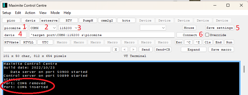

Bask in the days of V4, we had fewer devices to contend with and no TCPIP as an option.
In V5 I have tried to make it configurable in anticipation of the next device which will appear when I cease to be around to add it.
I agree that MMCC has a lot more "features" that can get in the way but I found that the ever increasing array of devices with subtle differences in firmware needed a different approach. It also made it easier for me to support Linux in two parts.
The simple way to use MMCC is:
1. Device type - picomite, CMM2, micromite etc
2. port name
3. port speed For picomites using the inbuilt USB port, the baud rate is not significant but must be present.
4. it is a good idea to give the device a nickname and
5. save the settings.
If you have a number of similar devices, you may want to change the port number each time before connecting.
Now when you edit a code file in MMEdit and are ready to send it to your device for testing, one click on the right most tool bar button "Load file and run it"
<F2> is the keyboard shortcut for "Load"
Edit: MMEdit's editor plus TeraTerm works well if you don't want the file manager in MMCC.

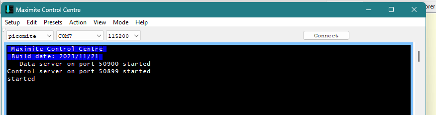

Having the internal editor is one thing that makes MMBasic stand out from the rest.
It allows anyone to edit using just about anything.
Even though I usually use MMEdit, I think it is very important to be reasonably capable of using the MMBasic editor.
I have heard the comments about MMEdit being a bit daunting at first so in the next update there will be the old "Full menu" mode and a new "Brief" mode which will be the default.
I hope that will help.
