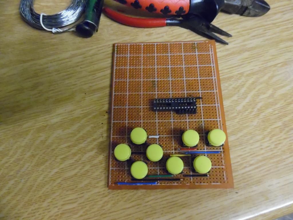

I built a mcp23017 expander and wired all the buttons 90 degrees the wrong way. Please form an orderly queue to kick some sense.
I wondered why the buttons didn't fit stripboard designer progs. doh.

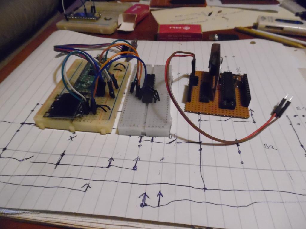

I think the vga keyboard that is 2 wires I should try with lcd. mcp23017 total rewire.I'm thick. thought it be a nice in-out board I'll try again.

I've messed up those tact switches often enough that I make sure I always wire them up on diagonally opposite corners. Then the 90 degrees doesn't matter.

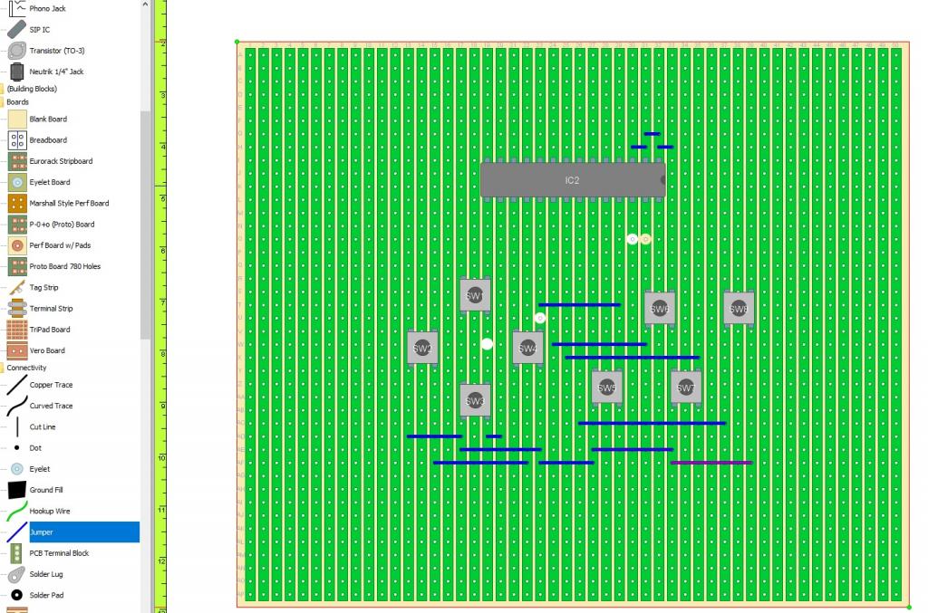

Using DiyLayoutCreator and like vcad, the buttons align if the right way round.
I don't know about placing buttons diagonally??

  stanleyella said  I don't know about placing buttons diagonally??
Buttons aren't placed diagonally--diagonally opposite pins are connected, making sure that you cannot be connecting to two pins which are already internally connected.

ncp23017 seems handy for 8 switches or on off and 8 outputs for just leds to show inputs. just 2 pins, sck,sda.

  vegipete said  I've messed up those tact switches often enough that I make sure I always wire them up on diagonally opposite corners. Then the 90 degrees doesn't matter.
That is exactly the approach I have used for years and indeed I used in the layout of the Game★Mite PCB.
Expanding on Vegipete’s description the trick is to wire the 2 connections on diagonally opposed pins as then no matter which way the switch is plonked into the PCB the switch will always be ‘correct’ way around.
