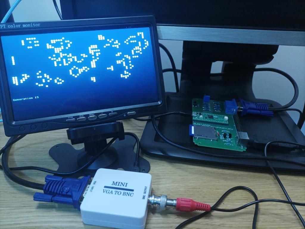

Recently been tinkering with getting an "art" project up and running, based on Conway's Life.
PicoMiteVGA to RCA adapter (Amazon) and one of those reversing screen sold for cars (eBay).
Here seen running... (don't judge the set up)

Nice VGA to CVBS converter. Some people on this forum are looking for such converter.
What is the type?

The CVBS is as @lizby posted - had it for a while via slow boat from who knows where - another lockdown "treat".
Long term, i'll make up a PicoMite VGA on protoboard for this as I wont then need the SD card / Keyboard and it'll be quite compact then - ideally fit directly behind the monitor itself - the plan will then be to mount it on a self as "art"  -- Or so I keep telling my other half as I try to convince her I'm not a hoarder.

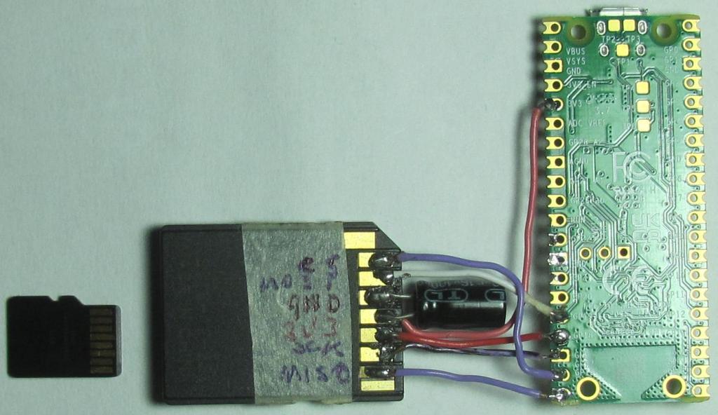

  PEnthymeme said  Are the micro SD card modules functionally the same or do I need a full sized SD Card?
This micro SD module works well for me, with maybe a half-dozen hooked up to picomites.
Some have said that the inline resistors on that module might cause problems, but I haven't seen any. Wired one with flying leads a few days ago to the bottom row of pins on one of these:

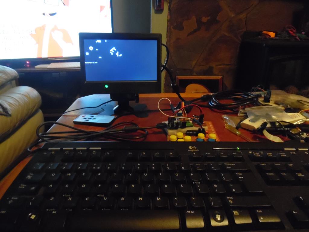

Posted: 12:34am 10 Jan 2024
works but small display (on small vga) and slow refresh sorry. zx spectrum was fast.

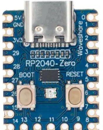

I traced the circuit of one of those uSD card modules. There are two supply decoupling capacitors and pullup (not inline) resistors on the signal pins. As the resistors are pretty high in value (10K) they don't seem to have any effect. I've used these a few times now with no additional decoupling and they've always worked well for me. Note, they are a true 3V3 module. There is no level shifting so they are ideal for a Pico.
Another fan of the RP2040-Zero. :)
