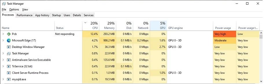

  Quote  Open up windows task manager, view processes and sort by CPU; then watch it as the freeze occurs. May show you if something else in the back ground is hogging resource
Here is a screenshot.

Solar Mike
Joined: 08/02/2015
Posts: 1255
Posted: 04:38am 23 Jan 2024
The only way I can get my version of Diptrace to give a "Not Responding" message is by getting it to search for a component and then attempt to do something else with it.
