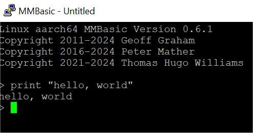

Posted: 02:47pm 28 Sep 2024
Raspberry Pi 4B with 64-bit Bookworm OS
Posted: 03:36pm 28 Sep 2024
Try this Lance:
https://github.com/thwill1000/mmb4l/releases/download/v0.6.1/mmb4l-0.6.1-aarch64-glibc-2.29.tgz
Note this is just a slightly warmed over version of v0.6, not the forthcoming v0.7 which is still in the oven until I'm satisfied it is cooked.

Posted: 10:45pm 28 Sep 2024
Perfect, Tom. Thank you very much.
Posted: 10:49pm 28 Sep 2024
  [ said  QUOTE=toml_12953Can this be used (minus graphics, of course) over a serial connection to a terminal?
Here it is over putty:

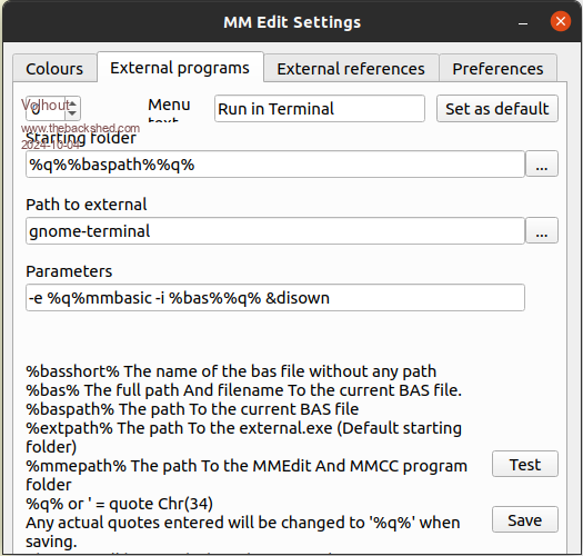

In my effort to use MMB4L (0.6) on an Ubuntu system (22.04) I read through your README and there is all sorts of mention of editors.
Well, here is another one that is simple to use: MMEdit, the linux version.
1/ Install MMB4L as in the description (chapter #2 in the introduction).
When succesfully installed, you can open a Linux terminal window and type "mmbasic", and it will open MMBasic. You can "LOAD xxx.bas" and edit it and run it.
2/ Open MMEdit (assuming you installed it)
Go to "File" the "Preferences", select the tab "External Programs"
Change the filed called "Parameters" as below.
Save the change.
In MMEdit you now can select the desired syntax (MMB4L V0.6 is close to DOS syntax, but has some features from CMM2). So you can choose either. Note MMB4L 0.6 does not support graphics and sound yet.

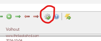

When you press the RUN button, your program runs in MMB4L.
At the end of the run, you type "quit" to close the RUN window. This is on purpose, so you see error messages that would be invisible when the window closed premature.
