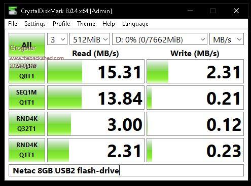

Stay away from the Netac 8GB USB2 flash-drives, if you want to save your sanity!
MOST flash-drives in the USB2 flavour, can manage at least 20-25MB/s sequential read rate, and usually between 5-10MB/s sequential write rate.
I thought these were kinda slow, so I tested them, and for brand-new flash-drives.....wow!
2MB/s write rate I think is a new low.  I have tested heaps of flash-drives, and even the ones they give away as a promo can usually acheive the more standard 20MB read and 5-10MB write, but not these!
I know, I know - Netac is a low-budget brand, so what can you expect, but these were interesting results!
I bought four of them, and ALL of them are the same when tested, so it was not just one dud one that I might have got.
Keep your distance from those drives!
In fact, when I setup one of these with a copy of Linux Mint on one, and Windows 10 on the other, BOTH of them generated read-errors during the setup process - as if the drive just basically gave up and stopped reading past a certain point.
I could send a report back to who I got them from(NOT ebay or AE, I got them from a NZ shop), but for the price of them, I don't think it is worth kicking up any kind of fuss.
Interestingly, I have used Netac SSD's before, and they seem to run beautifully.
Fast and never any problems, so I guess.....the luck of the draw perhaps?
