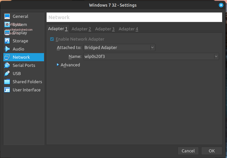

Ok, these are the results, considering I don't have a printer connected to my PC via USB; it is a wireless printer.
1) After installing the SO in your VM, change the Network configuration from NAT to bridge. This will allow the SO in the VM to see your network.

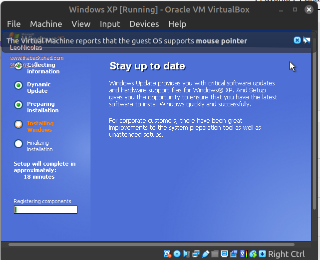

2) I have tried Windows XP with no success. It is too old for my wireless printer.

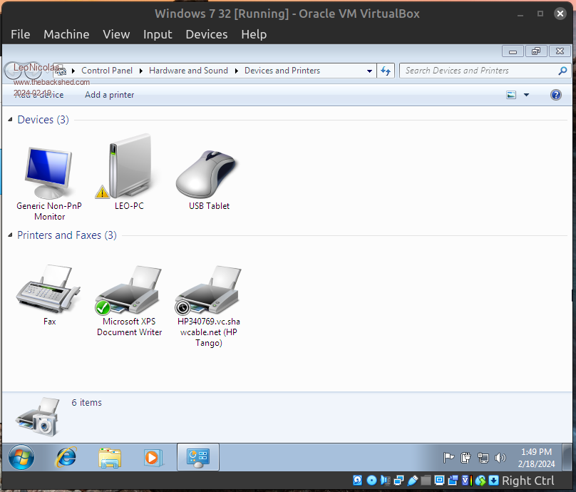

3) I created a second VM with a Windows 7 copy I downloaded from Archive.org
https://archive.org/details/Windows7-iso

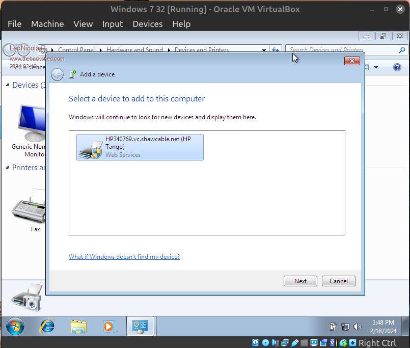

4) After installing Windows 7 (and changing the network to Bridge), W7 could find my network printer without any issues and automatically install its driver.

I did have to go and download the W7 driver for the network printer, but once I did that(inside of W7 in the VM), W7 picked up the printer and I could print a Windoze test page to the network printer on Linux Mint.
Encouraging!

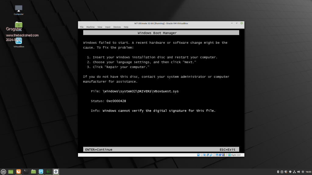

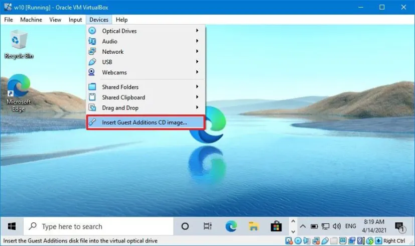

As soon as I inserted the VM Guest Additions ISO into the virtual CD-ROM and ran that(inside the W7 VM), that completed fine, and wanted to reboot - so I let it.
Now W7 bootup crashes, and not even the W7 ISO and repair utility can get it back again.  Looks like back to square one.
Not sure what the hell went on there, but....
LeoNicolas
Joined: 07/10/2020
Posts: 625
Posted: 05:16am 21 Feb 2024
In my tests, I installed the VM Guest Additions ISO from inside the Virtual Box menu. It worked fine.
Posts: 10071
Posted: 05:21am 21 Feb 2024
Yes, that is what I did.
W7 then wanted to run the installer, so I let it.
That completed fine.
On reboot, it dies.
I setup a brand-new copy of W7, and the very first thing I did, was insert that image and run the installer, and even on the completely clean install, it fell over a died and would no longer boot.
This time, I grabbed a screenshot of the error:
Oh, BTW....YES....I ticked "Trust software from Oracle" etc during the setup, so Windoze should not be bleating about this at all.
I wonder if there is a bug in the latest version of the guest additions image?
EDIT: Or perhaps the download of the ISO for the guest additions I have is corrupted or something?  I do remember using the guest additions before years ago when I was last playing with VB, and I don't remember there being any problems.
Edited 2024-02-21 15:27 by Grogster
