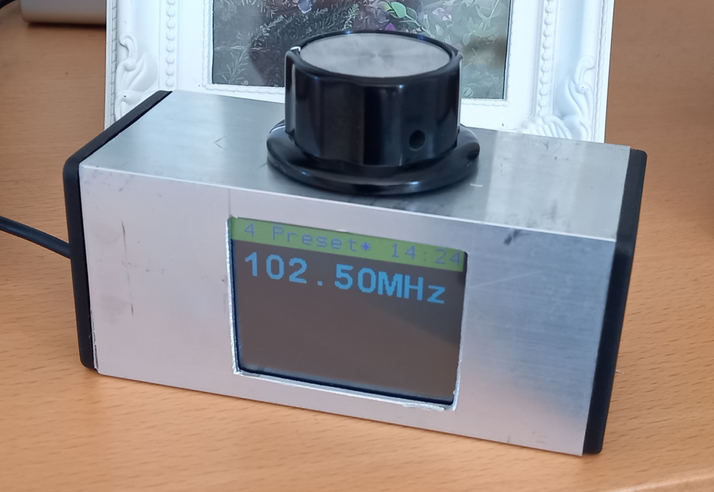

My radio works well but the backlight for the display has failed and seeing what you are doing is not easy.
The two radios have different features so trying to get one MMBasic program for both was not easy so I stopped trying.
Consider the attached a collection of wrappers for the FSapi and don’t take too much interest in the rest of the program.
I used a cheap rotary encoder for the control but I think I will try a small joystick instead. That will suit me and importantly my wife better.

The picomite is used as a replacement for the failing display with the advantage of being able to place it where ever I like and have the text big enough to read.
I managed to squeeze it into a short length of 50mm square tube.
