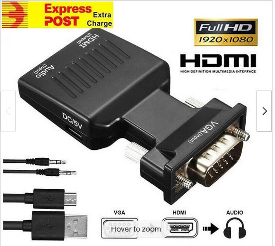

Hi RicM, All,
The one I use looks like this unit.
Be aware that there is another one that uses the same case to works in reverse (ie. converts HDMI to VGA) check when you order for the text showing input or output in brackets.

Posted: 11:33am 15 Mar 2024
Mine looks like BigMiks, but just note you also need to provide separate power to the adapter via a USB cable. I just use a normal phone charger and it works fine.
