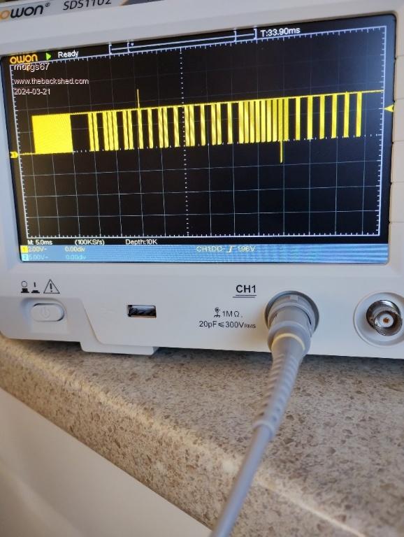

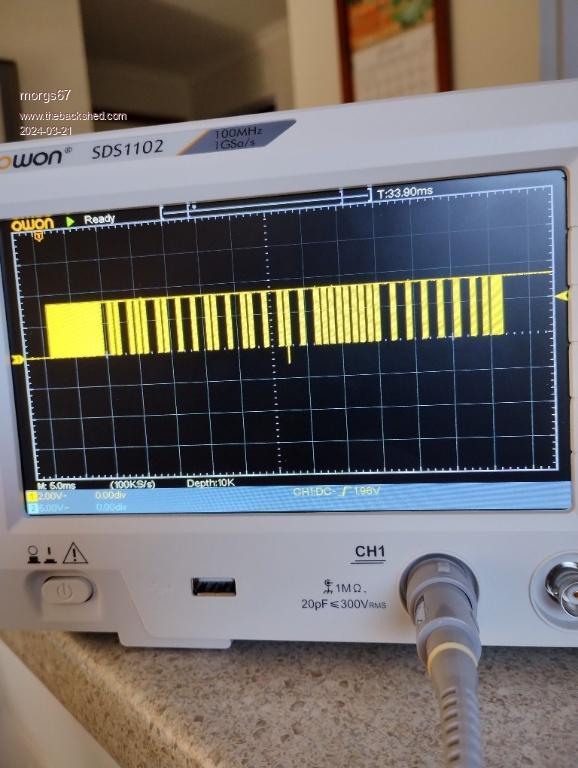

The above code with the IRpin changed to (pinno PE0} on the ArmmiteF4 does not work.
After investigation it appears that "d(672) = 4500  'pause after start pulse train" is not interpreted by BITSTREAM.
It shows up in the d(0) to d(800) bitstream exactly the same as the picomite but does not result in the 4.5mS space after the leading pulse burst.
test values are devicecode  19832 keycode 192.

Your scope pics indicate all the bitstream array index values are off by 1 anyway. It doesn't affect anything I have but I will tidy it up anyway.

Phil,
There is more that is weird.
The bursts are 42 cycles of 13us = 546us (not exacly 562, but close)
The pauses between the bursts must be 562us (logic 0) -or- 1686us (logic 1).
Look at both scope plots. Either the burst timing is wrong, or the pause timing is wrong. Visually there is simply too much burst visible.
Checkif a single cycle is 13+13=26us. It feels the burst is 800us, in which case 13us is more 20us, 38kHz is 25kHz.
P.S.... this feels like a job for PIO. Shift the 32 bit NEC value in FIFO, and let PIO do it's job. But I guess this is for the F4. No PIO.
Edited 2024-03-21 23:47 by Volhout

The apparently wrong timing pointed out by Volhout are correct on my scope and the Sub works on my devices.
Perhaps a display artefact in the images?

 '22/3/2024 - new NECSend routine to replace original due problem with 4.5mS space generation

 Math set 14 , d() '14=1000/(38*2)uS duration of a half cycle @ 38kHz
 BitBang bitstream IRpin, 670, d() 'send 9ms start 38kHz
 Timer =0
 For m = 43 To 1387 Step 42  'load data sent after start sequence
   d(m) = (((word>>(32-n)) AND 1)*2 + 1) * 562.5  'convert bits to duration (short = 0, long = 1)
   Inc n 'step to next data bit
 Next
 Do : Loop Until Timer > 4.3 'send 4.5ms start space
 BitBang bitstream IRpin, 1387, d() 'send the data
